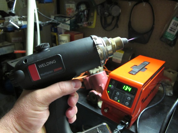

I'm not a big fan of using the MultiPlaz 3500 for cutting metal.
(Good fusion welder though.)
Reconditioning the tips shouldn't be too hard.
It's only the orifice that gets worn out or 'out of round'.
The cathodes have a hafnium insert and would be harder to recondition.

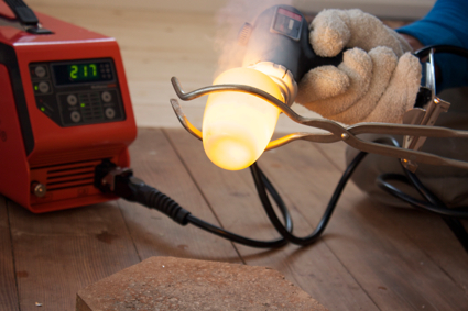

It's a crucible, used in metal casting, for the manufacture of small parts.
I bought all of Stephen's books. http://stephenchastain.com/store/
No need to waste all of the turnings from the lathe.
Melt them down and make something with them.

There are similarities, but it's a steam plasma torch.
http://www.plazarium.com/products/steam ... arium-sp3/
https://www.youtube.com/watch?v=Jyf1Kju ... bm6qWD6J9e
http://www.youtube.com/watch?v=oiAAASySa1s
