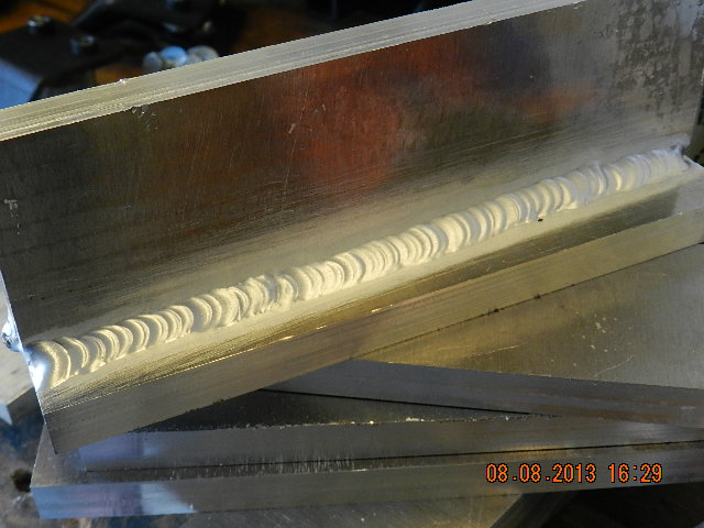

I own an Everlast 250EX with the water cooler set-up. This is a serious machine. Take a look at the half inch plate of 6061 I ran at full power just for fun. It ran it without breaking a sweat. The AC frequency adjustment set to 20 hz is amazing on this thick stuff.
- DSCN5333.JPG (122.68 KiB) Viewed 3096 times
