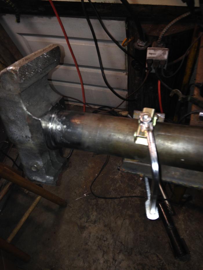

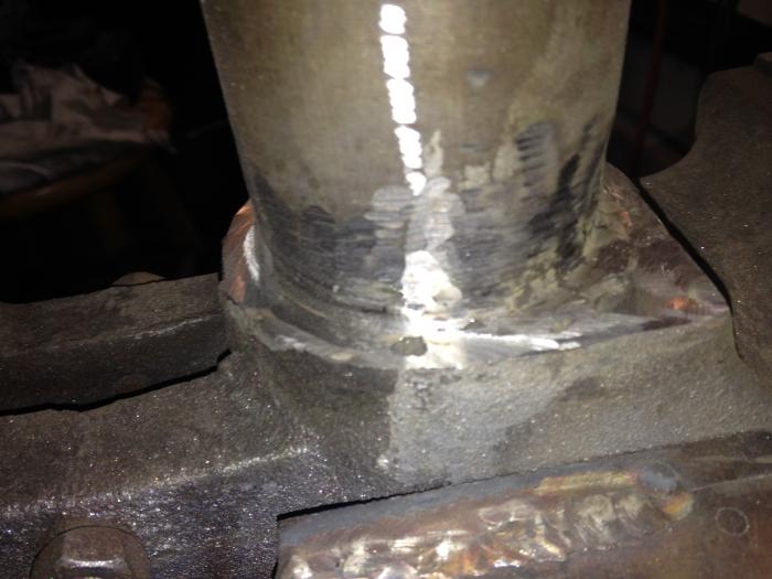

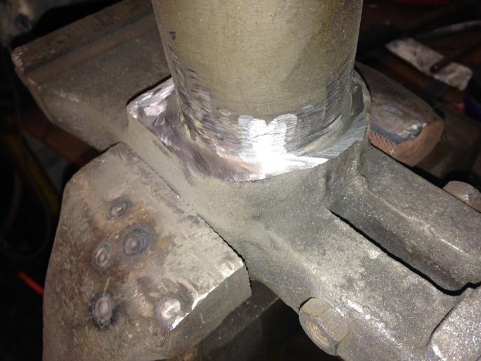

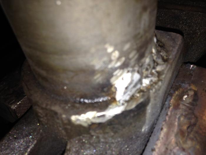

Ok Guys, got a vice repair job I'm doing, It was broken by a dillwipp with a 4ft pipe.
Then it was "repaired" with stick. 7018 to be exact.
It then recracked.
So I'm gonna try and repair it.
You can see the weld, full of porosity and deep cracks.
So, I ground it out, I'm still grinding, wire wheeling and degreasing.
So I am looking for a solid welding process, I have access to some good mig, stick, and tig welders.
But what stick electrode, mig wire, or tig rod would do the Job????
I'm not willing to pay outrages prices, like $87 for 1lb of nickel rods!!! no way....
What would you use?
~John
here's some pics after grinding

just about ready to weld.
- IMG_0566.JPG (68.33 KiB) Viewed 3030 times
- IMG_0567.JPG (85.66 KiB) Viewed 3030 times
- IMG_0568.JPG (107.99 KiB) Viewed 3030 times
Just about ready to weld, I'll take a .045 wheel and do a little gouging in there and a little smoothing.
What filler would you guys recommend?
John

Cheap fix...
Grind it out heavy, each side of the crack. Stop-drill the ends and grind to them. "Butter" the exposed cast with 309. Then weld it, also with 309, in stages, keeping the metal hot. It wouldn't hurt to throw some garden-center vermiculite on it when you're done for a slow cool.
This doesn't always work, but it has for me in the past, when I can afford to spend an hour or two more than I can afford some high-nickel rod.
One other thought... Cast piston rings (available free as scrap from any local engine shop) are high in nickel, and work well as filler for a TIG fix. Werkspace can tell you more about this.
John,
Looks like you have a project! I would honestly use the 99% nickel rod but I understand why you don't want to purchase any. Don't you have something like a Tractor Supply ( an hardware of sorts ) they sometimes have some nickel rod in smaller packs.
If you only have 7018 I would recommend preheating to 200-250 degrees F and keeping that temp the whole way through and putting it in insulation/sand for a slow cool. I think the 7018 would hold if it were not a item that would be seeing stress. Do you have any other electrodes?
If you go the TIG route I think using 309 would work, but I have never don't it myself.

309 with tig or 309 stick would work. 7018 will also. I like that piston ring idea, gonna have to remember that one. Post heat on any of these will give the best results. I usually use a bucket of sand but you can also use an oven and back off the heat over a few hours. The wife may not like the oven idea but it works great.
I'm open to any repair techniques, Just as long as its cheap and strong.
SW, I can't believe you can find 1lb of nickle rods for $10!!! 1lb of Forney is $87.
Would the Nickle Stick be the way to go? I could prolly find some nickel rods. I'll have to try and buy some.
Or could I Use 309 Stick???

I would go with NiCl. Its meant for cast and at ten bucks if it doesnt work its a cheap lesson learned. Better than 87 bucks.
I'm with you on the cheap lesson learned, those are the best lessons
But I'm considering the 309 tig route.
So I should preheat to 300deg????
What amperage should I weld the first pass? 160amps? Should I weld Like Jody did in this video
