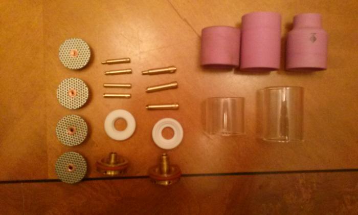

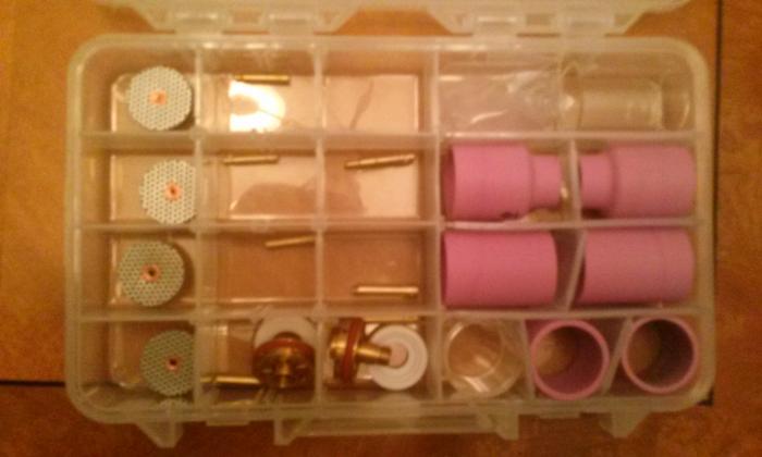

Well here is my 2 cents on the matter and let me start by saying I'm a TIG parts collector, If I think it would be useful I build a kit around it. Any way for starting out I would stay away from the pyrex at first. My suggestion for starting out would be to go with a Gas Lens set up. The gas lens allow you to stick tungsten out a long way so easier to see puddle. They offer good gas coverage plus you can even turn down the flow rates over the standard collet bodies if you wanna save on gas. I suggest getting wedge collets will last you a lifetime and buying alumina cups in a size 7 and 8. The cups are pretty cheap buy a box of ten and your set for a long time. This set up will allow you to pretty much weld anything you come across in reality. I build my own kits instead of ordering what someone else put together. I can normally get more bang for the buck that way and I don't get stuff I don't need. A lot of kits throw in backcaps and tungsten I buy boxes of tungsten and don't really want a couple of loose pieces laying around. usaweld.com is great place to get all supplies you need and ship fast too.
This is really what you need
Now I did get the pyrex set but my purpose was for better gas coverage on specialty jobs. even then I didn't buy a kit but built my own. reason being is my kit fits the 9 style plus the 17,26 style. The actual gas lens screen on left and cups on right is used on both torches. The insulators and actual collet body ( big brass piece) is what is different between torches. so if you shop right you can get the whole setup for both torches cheaper then some kits for one style torch. I added large Alumina cups to my kit because the pyrex is easy to break and if I can't see around the alumina cup I could use the the pyrex then. The large style lens offer great gas coverage but I find there name gas savers to be a misnomer. In reality I have to turn up flow a lot higher than a standard gas lens do to the large area that this blankets in argon.
I cant Really say the clear lens offers a better view of the puddle you can get such a far stick out with these that I have yet to find my self looking threw the cup. I was missing around on some 5/8 4130 tubing doing T joints when I got them and was able to use the alumina cup and never had a problem seeing puddle so cant really say the pyrex is to useful.
this was made by ordering a .40 kit for a 9,20 style with an 1/8 kit for 17,26 that gave me insultors, cups, collet bodies for for both torches. Then just order lens screens and other wedge collets I needed for other sizes plus the alumina cups. This was bought for titanium projects which I will begin working on this spring where the regular gas lens will not provide coverage needed.
Before buying kits start adding up individual parts and I bet you can build some great kits cheaper then what most places offer. this is one of my 9,20 style kits and my large diameter pyrex kits for 9,20,17,26
If you need assistance with part numbers I can help you if you need it. Overall I cant honestly say get yourself pyrex. I believe they have a limited speciality use and are a pain in butt to clean. Your gonna be dipping tungsten a lot starting and glass will fog up quick. I would save your money get 2 boxes of tungsten sharpen everyone and when you dip put a new one in. Heck of a lot better than constantly sharpening same tungsten over and over. when all 20 have been dipped time to stop welding and sharpen tungstens for awile.
