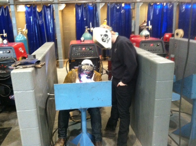

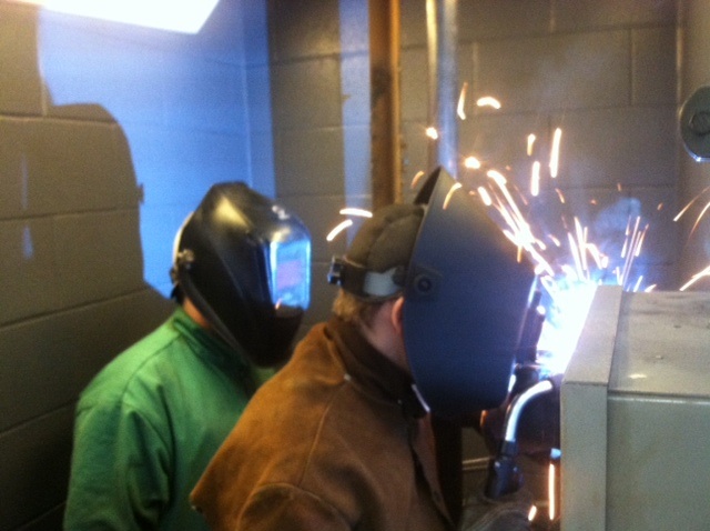

After a excellent lunch prepaired by the culinary class consisting of sea food it was on to the Seniors. Again, the Senior class was just as eager to learn. They were welding GTAW, GMAW and SMAW and that alone kept me on my toes. They began with a few doing SMAW while I worked with a couple students with GMAW-P with a Lincoln C300 and Miller Pipeworx, neither of which I have ran before. We started with the Lincoln running .035 and 75/25 gas. After getting it dialed in a little I explained how it will run better with 90/10 so we switched out bottles and they noticed the improvement in the arc right away. I also showed them a little on 3G pulse basics on the Miller. I didn't care for the Miller as of now anyway. It was harder to dial in, which I never got right, but I am sure with more time it would be a great machine. Impressive to me was the fact that the two students I was working with directly were able to weave up the plate rather well. I believe with a little more helmet time they will have no problems passing this test. I also spent a few mins with the two Skills USA regional champions who were quite impressive with their skills. I wish them the best of luck as the move on!

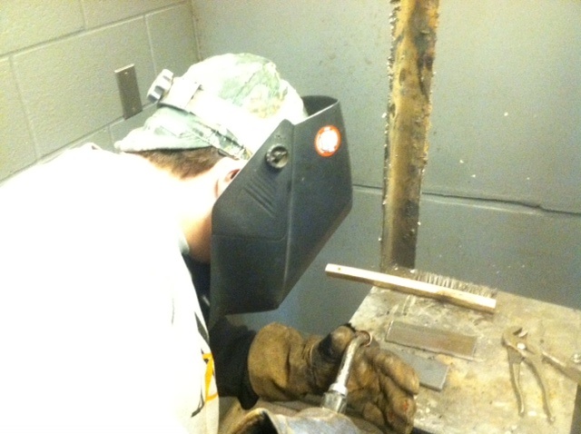

Here are some random pics of some of the Seniors.

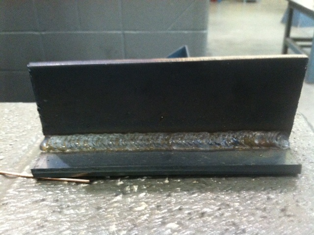

Just to clarify the students running horizontal 7018 are really not weaving but using a slight side to side oscillation in the puddle. The purpose of this as Jonathan said is to teach the students to control width and increase the likelihood of undercut from a long arc and having unequal legs. Let’s face it running a horizontal fillet is not that difficult. Having them increase the leg size with oscillation forces them to learn how to deal with undercut and unequal legs, skills that will help them as the tasks become more difficult and when they move into different processes as well. Everything I have them do has a specific purpose beyond having to weld in the easiest position first.
Here is an example of a student who can make a nice weld but I have challenged him to make it bigger just so he learns how to do it should that situation arise someday. The results of the larger weld were not as nice but I failed to take a picture.
