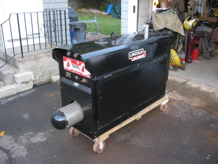

I just bought a used SA200 and would like to find out if it has copper or aluminum windings. How do I find this information?

Look at the stator right behind the engine where it is mounted to the frame. If it is shaped like a stop sign (octagonal) then it is wound with copper clad aluminum. If it is round then it is all copper. Red face plate or black face plate also will give a good indication but it is not definite. Also if you search by serial number on Lincoln's website you may be able to find out by year. Some black faces were actually built with the full copper windings. I belive the actual switch was made between 73 and 74. The best way to tell though without a teardown is by the stator.

by Sanford
Copper
sa200 21.JPG (57.44 KiB) Viewed 4980 times
Not copper
like previously said the stator with the squared of edges aren't copper
I rebuilt a red face a few years back and sold it........ wish I hadn't but I had no use for it. Sure did weld smooth.
sa200 28.JPG (57.72 KiB) Viewed 4980 times

by nickn372
