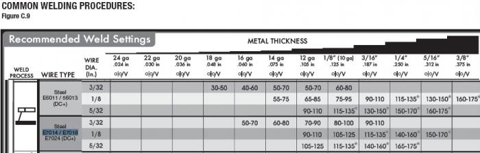

Following mucho practice and some instruction, my first projects will be repairs and a custom upgrade on my steel dumpsters. 1/8" patches via mig....and will use this for some stick practice also to get a feel for the machine. But the upgrade...that will involve 1/4" tube and 3/8" plate, and must be strong!! ***So I want to know if I'm buying enough machine to do this - is the short version of the question.*** The extended version and details of this question to follow.
The chart of settings I've also attached from the manual only goes up to 3/8" plate - does not suggest mig for this, leaving their only recommended setting 1/8 stick "E6011 / 56013 (DC+)" 160-175 amps - again 175a being the max the unit does in stick mode.Please see the attached photo
These are 10-12 yard dumpsters - not monster 20 or 30s - BUT, this upgrade is so my larger 33,000gvw truck can pick them up when they are too heavy with e.g. fine rubble and the smaller Isuzu can not lift. So I want it to be plenty strong.
So the questions please:
1) Do I have enough power in this machine to weld the 3/8" plate to the 1/4" tubes? Is 2 passes a sound plan for this - and mig or stick? I really do like the ease of use of this machine with its interface, and that it's not an import with questionable specs/customer service as with some, but perhaps not all of the import companies.
2) I'm concerned about not being able to use 7018 (manual says max 5/16" with that electrode) for that 3/8" to 1/4" weld, by the specs - but wouldn't 7018 ideally be a better choice than 6011 for strength? Or should I try say first pass with 6011, then two more passes with 7018?

The Lincoln 210 Welder's recommended settings chart

As a beginner I would recommend using 3/32 7018 at 70 to 95 amps depending on the thicknesses you have mentioned. I have also recently bought the Lincoln 210 mp. Plan on making multiple passes. I've welded on pipe with a wall thickness around 1-1/2 inch this way it got exrayed and I never had any issues. Just put in lots of practice time! Plan on going through 50 - 100 lbs of rod and you won't regret the practice. There are some other rods that will also do what you want this is just what I like.

Have to admit as a newbee I'm now a bit confused. For 7018 the Lincoln spec only shows up to 3/16" metal with 3/32 rod, or 5/16" metal with 1/8 rod.

Those specs in the chart are based on a single pass. For 3/16 material, you should not have a leg of the weld bigger than 3/16. This does not stop you from stacking welds to weld heavier material. It's not uncommon to take a 1" plate test, in either butt or fillet configuration with a 1/8" rod, for example. It's up to the user to put down the right amount of metal with each pass to achieve the best strength.

So should I not be concerned about welding the 3/8" -> 1/4" only having 175amps available in stick mode?
What about the first pass 6011, then 2 passes 7018 train of thought?
And on that note, is Mig a consideration for the buildup passes and the straight 1/4 -> 1/4 tube welds? Perhaps something like flux cored gas (75/25) shielded Lincoln Outer Shield/ESAB Dual Shield?

OK....So I ordered 6pounds of 1/8 Excalibur 7018 in one pound sealed tubes. And some cheaper 7018 and 7014 for practice.
Any thoughts between 6011/7018 on which will give me better penetration/strength on the first pass given the limitations of the LE 210 and the chart I attached in first post? At the hot end of the chart each would be run as high as 170a maxing out the machine.

I would multi pass with 7018 and I wouldn't give it a second thought.

Why? 7018 has a higher tensile strength. Penetration? As long as your weld pass has securely bit into the base metal you're fine. Especially if it's a multipass weld. Bevel the components and keep pounding! We never used any 6011 on the submarines and you can't get much more stress on a weld than being under a few hundred feet of water! :shock: :o 8-)
Now for a word of warning from an old man. When welding dumpsters. When you think you have enough weld there, keep welding. I personally witnessed a lifting hook on a 42 yard compactor dumpster tear away from the lifting plate and total the truck. The cable came over the top, crushed the roof, blew out the glass. took out the hood, radiator and supercharger
