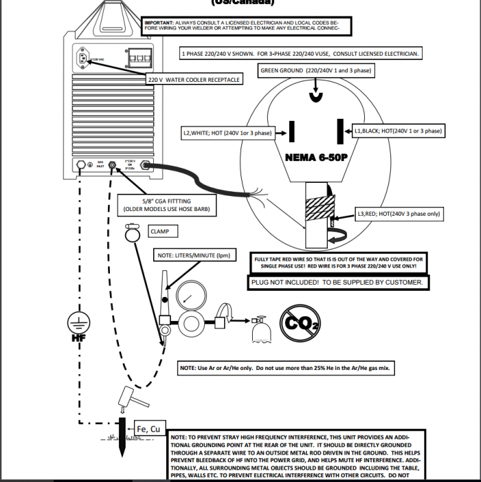

I recently put a 220 dryer plug on my AC stick welder and it keeps tripping the breaker. The dryer (and stove) receptical is a 3 prong with 2 hot and a neutral. The welder is 2 hot and a ground. When hooking up the dryer plug, I hooked ground to neutral thinking that it was a ground. Are they compatible or is that why my breaker is tripping? I've tried 3 different 50 amp breakers and they all trip.
If it is, can I just cap the neutral on the plug and ground to something else? I would be sure to not touch the welder (while it's plugged up) without my gloves.

i beleive your welder's manual should have a page saying the setup of prongs, the phase, and the type of plug needed.Tom94 wrote:I recently put a 220 dryer plug on my AC stick welder and it keeps tripping the breaker. The dryer (and stove) receptical is a 3 prong with 2 hot and a neutral. The welder is 2 hot and a ground. When hooking up the dryer plug, I hooked ground to neutral thinking that it was a ground. Are they compatible or is that why my breaker is tripping? I've tried 3 different 50 amp breakers and they all trip.
for example, this is what my powertig 250ex needs:

The neutral and ground is only tied together at ONE point. At your main service entrance panel. All subsequent you remove the bonding jumper. This includes branch circuits and sub-panels. You need two phases, and one ground. The only reason you would need the neutral is if you had some type of control/display and it did not contain it's own dedicated control xfmr.
And so you are aware, a neutral is a current carrying conductor.

The dryer and stove should not be 2 hots and a neutral if they are 220 volt. What is most likely going on is that the dryer and stove wiring is not properly color coded. Open your welding machine and see where the wires are attached. The two hots will most likely be attached to the switch but one may be attached straight to the transformer. The ground should go to the chassis or a lug on the transformer. Does the machine work if it's powered up at a different location?
