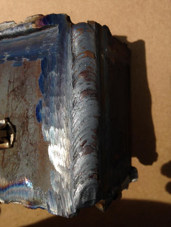

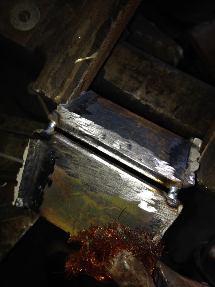

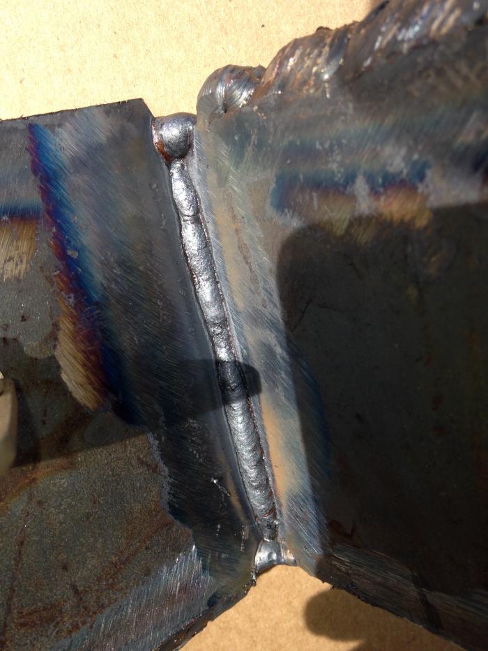

Ok,
Got two pieces of 1/4 inch thick, 2inch wide flat bar....
Outside corner joint, bout a 1/8 gap.
HH135 maxed out.
I did two joints, one was a single weld, other was a 2pass.
Pics....
These three pics are of the single pass weld.
    Wed Oct 23, 2013 3:30 pm
    Palmer AK
    Palmer AK
    Palmer AK
Ok,
After spamming up this thread with nasty welds, I've got to explain whats going on.
The first weld was single pass, real slow, smashed it in the press, split on the toe of the weld.
I was using a 12ton press, it took some power, but it just broke.
Second weld I did was two passes, first was fast and small, second pass I did circles.
That really took some pressing, but it finally gave....
My verdict,
Even if a weld looks fused, it may just be setting on the surface.
Preheat makes a lot of difference....
