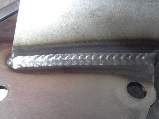

Steve inspired me to try this MIG like TIG practice. I was not trying to get to aggressive, but wanted to keep this thread going. Specs; MM252, ER70S-6 .035, 18.4V 265 WFS. Enjoy.
- MIG like TIG.JPG (110.82 KiB) Viewed 3144 times
More heat there Johnathan!!!
Looks a little cold for my taste....
~John
~John
John,
I would agree with you if this were a weld to depend on. I will go out on a limb here and say while I do like the MIG like TIG look, I do not like it as common practice for my welding projects. I gave this weld a total of one minute and moved on. I much prefer the smooth and hot weld, as I feel this burns in deeper and is safer. Now this is not meant to offend or start a discussion on which is better, as I don't want to hijack this thread. Stay with the MIG like TIG theme and I will give it another go in the future.
Hey, no offense, just the critic in me.
I like a smooth, flat, washed in weld.... just me I guess.
~John
~John
Absolutely no offence taken!AKweldshop wrote:Hey, no offense, just the critic in me.
I like a smooth, flat, washed in weld.... just me I guess.![]()
~John

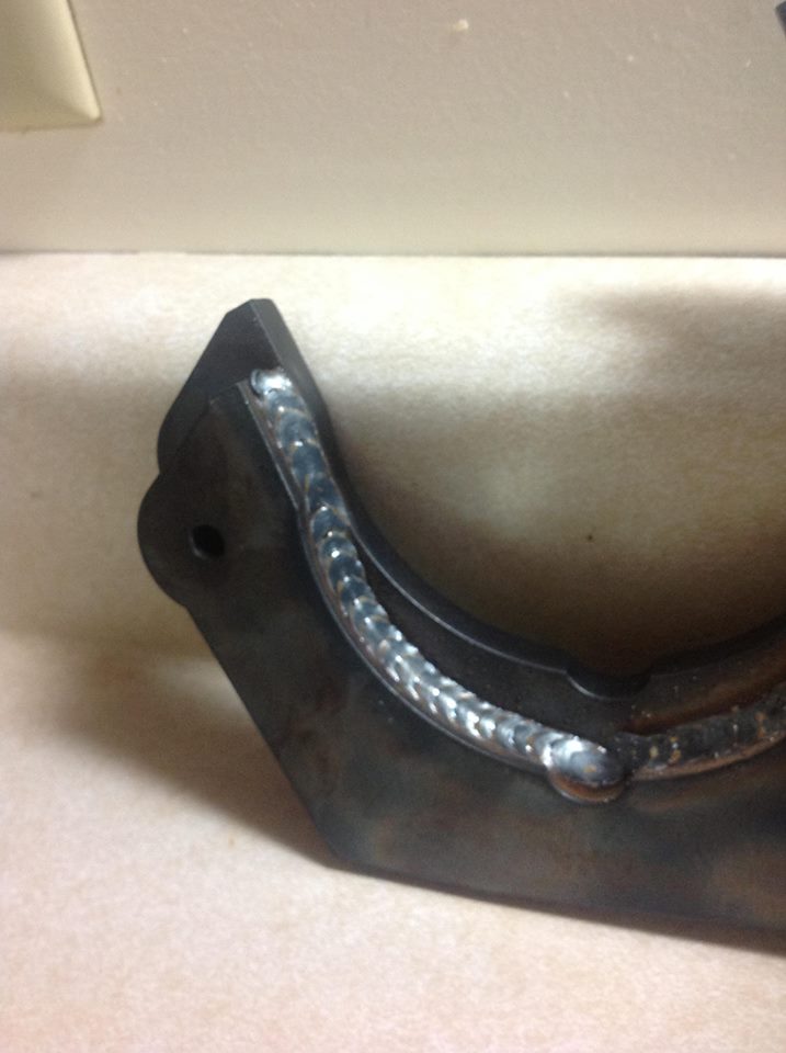

Well I came home and gave it a quick shot again. Not much different but here it is. I would like to see some of you give this a try. Now that I have started, I won't be satisfied until I can get it to look like ZTfab's.
- MIG like TIG 2.JPG (123.36 KiB) Viewed 3371 times
Thought I heard somewhere that he uses a CNC stepper machine....

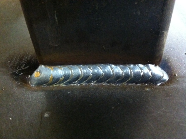

Here's a few I done
- 20140401_084248.jpg (40.15 KiB) Viewed 3356 times

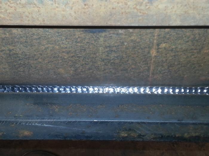

- 20140401_112732.jpg (48.58 KiB) Viewed 3356 times
- 20140401_112918.jpg (48.01 KiB) Viewed 3356 times
Nice! What were your specs?

Again,
Looks too cold for my taste.

Wow, 18ga.
I'm sorry.
I thought it was closer to 1/4.
If that's the case, WOW!!!!
I'm sorry.
Lolz, The extreme close up makes it look like Half inch plate. The weld must be tiny. Still buff off the scale though.

Sorry guys let me correct myself its 3/16 . I posted the wrong pictures . You are correct ak good eye even looking at a picture lol
soutthpaw
- soutthpaw
Location:Albuquerque NM
That is where the dime next to the weld helps to show actual sizeweldin mike 27 wrote:Lolz, The extreme close up makes it look like Half inch plate. The weld must be tiny. Still buff off the scale though.
