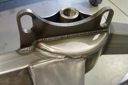

Like the outside corner in the foreground?
Is that the appearance you're referring to?
I realize it's not perfect... the parts were torch-cut freehand. I'm just referring to the "stacked' look.
- GEDC0496.JPG (186.02 KiB) Viewed 8426 times
The curved weld in the background is done uphill.
The foreground weld is downhand, done full open-corner. (1/4" material.) There's a decent horizontal, too, but the camera angle doesn't show much but the toes.

good work Steve. thats exactly what I am talking about.
Got any tips to share on how to make it happen?

Thanks, Jody,
It's really the same advance-pause as in TIG, but the feed is automatic. The motion isn't as smooth as in TIG; It's a rapid move forward, about half the distance as the finished weld is wide, and pause while the puddle fills. On a downhand, I'll move slightly back into the puddle during the fill (dragging about 15*, so the arc-force is "up") until the edges/corners fill out. Propping is critical, but with the mass of a MIG gun to resist shaking and the ability to put both hands on the gun, an elbow is an adequate prop.
I've just been doing it reflexively, so it's hard to explain, if that makes sense. I have some coming up, and I'll pay attention. Maybe I can explain better.
Due to the nature of that project, it never occurred to me to take more pictures of the MIG... It seemed like an afterthought at that point.
Steve

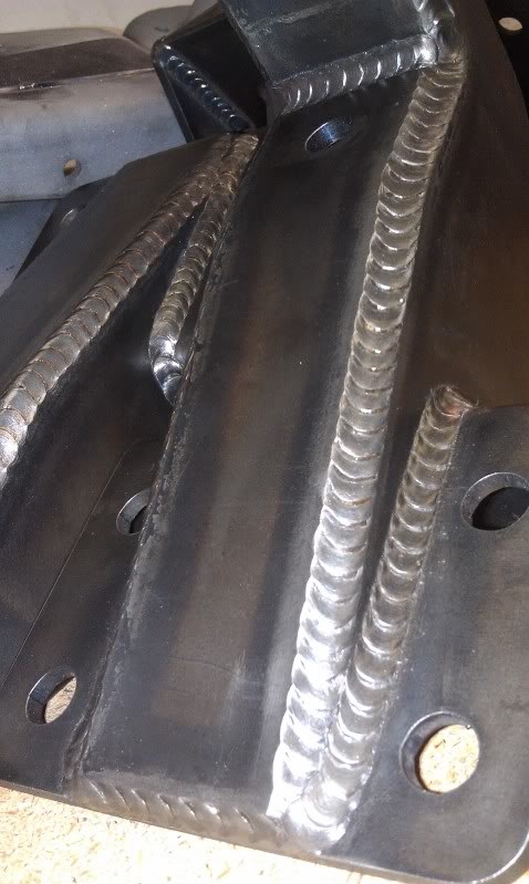

Here's a pic of welds on a cup-car frame that were made by "pumping the trigger." They look nice, but I typically run hotter than this on my MIG welds - on the hairy edge of a spray transfer
I still get a ripple pattern that looks nice, but what I'm really looking for is penetration - especially with a structural MIG weld. But hey, some things just have to be "good enough" and making it look "pretty" shows talent and craftsmanship.

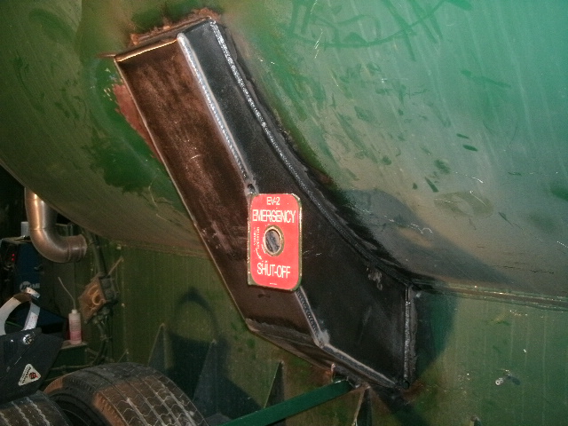

My primary client insists that any repair weld be left "as is", except for spatter/slag, and the rounding of sharp edges on outside corners for paint adhesion. They can then see immediately where any repair is, and can roughly judge the quality of the weld by appearance.
