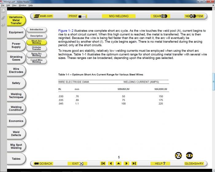

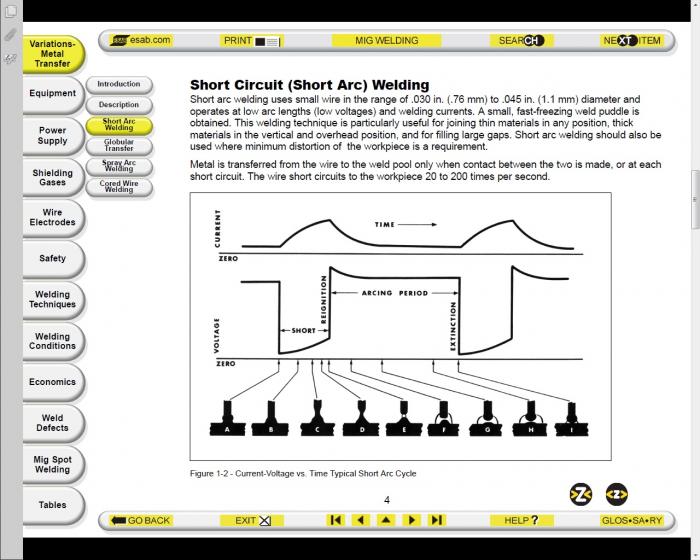

Here are screenshots from Esab University's MIG CD rom. This disc was free from Esab (so not a copyright infringement or TOS violation). Haven't yet figured out how to insert multiple images in one post, so looks like one image in many posts.
Short arc, part 1
Short arc, part 1
- short arc 1.jpg (65.03 KiB) Viewed 2332 times
