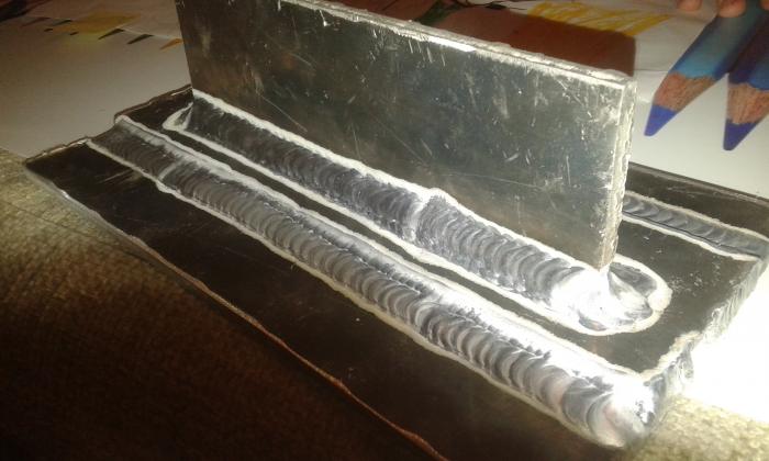

Hey Welders, Here is my take on basics for Aluminum Tee joints.
please chime in with what works for you.

If no one else will say it, AWESOME VIDEO, JODY!!!!

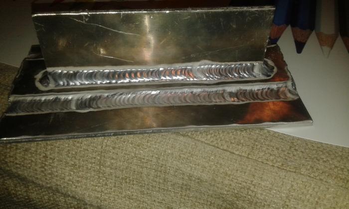

I think it was very good video. Because jody showed that lack of fusion at beginning on aluminium weld. I have done the same mistake when you feed that rod too soon. Many can weld some kind of weld on AL, but making sound long lasting weld not to crak in years in use is bit harder. Im no expert on AL but welding it time to time to keep the touch of it.
- 20150207_185019.jpg (43.72 KiB) Viewed 1275 times
- 20150207_185220.jpg (40.41 KiB) Viewed 1275 times
