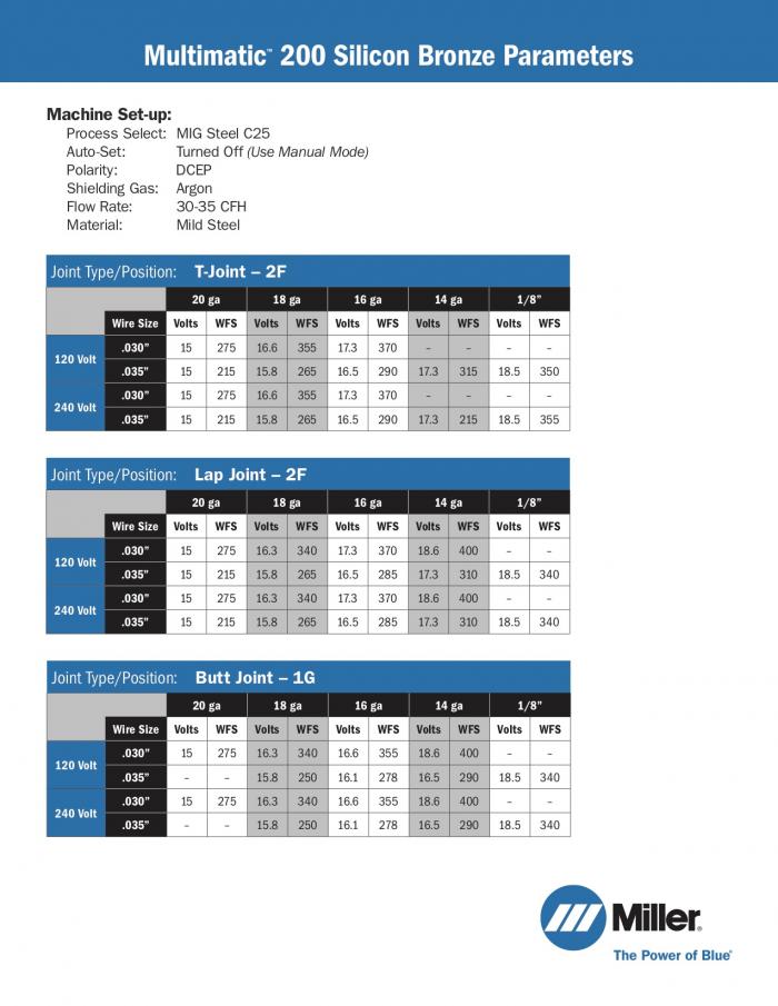

That’s right GMAW I mean GMABrazing silicon bronze with a mig machine. I’ve recently read about this process and can see a huge advantage to this way of one doesn’t own a TIG Welder (most home hobby shop guys) and had to weld some smaller pieces. Perhaps a cast iron repair that won’t be subjected to heat cycling. Or joining and dissimilar metals.
We all know how useful brazing can be, and it would be great to be able use a mig machine to do it.
Ideas & suggestions for videos
Its also great for sheet metal repairs (think body work or replacing rusted auto panels). Trick is to get your heat settings right on MIG with the wire speed. Takes LOTS of tinkering. But MIG tacking with SilBr is a much faster method than using 70-s2.
Where did you find this pdf? I’ve seen it before on the internet but can’t find it again. It was the full list of all metal sizes, types, gassed, and short circuit vs spray.gocirino wrote:Or you could use these settings to get you started.....
Miller Website!Homemade wrote:Where did you find this pdf? I’ve seen it before on the internet but can’t find it again. It was the full list of all metal sizes, types, gassed, and short circuit vs spray.gocirino wrote:Or you could use these settings to get you started.....
Homemade wrote:Got a link? I’ve scoured the Miller website already and can’t find it.
The one I seen was for a mm252
https://www.millerwelds.com/resources/a ... ing-basics

I know this is a old post but i mig aluminum and silicone bronze with my HTP Pro Pulse 200 it has special synergic programing and runs it smooth no issues.
