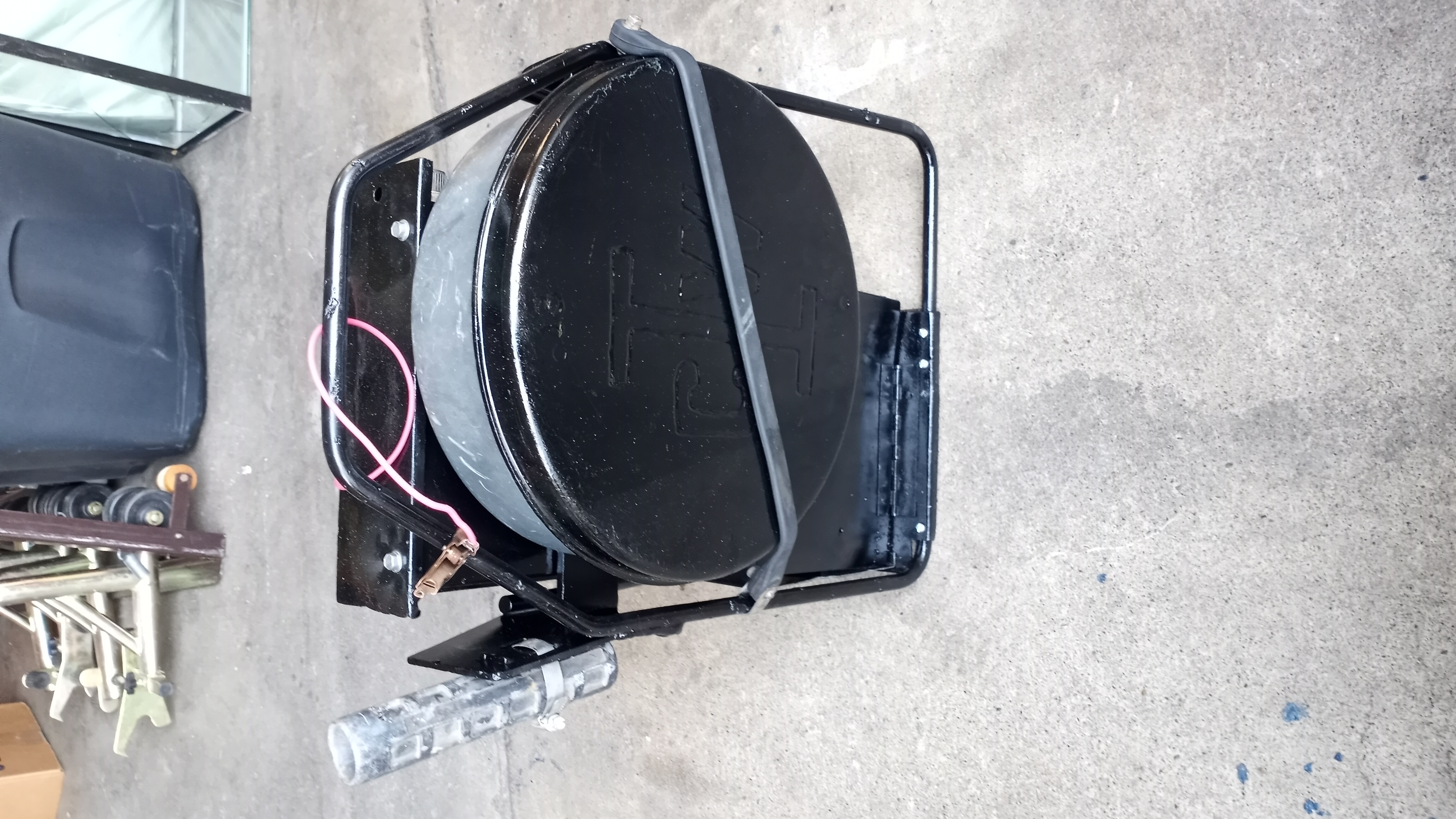

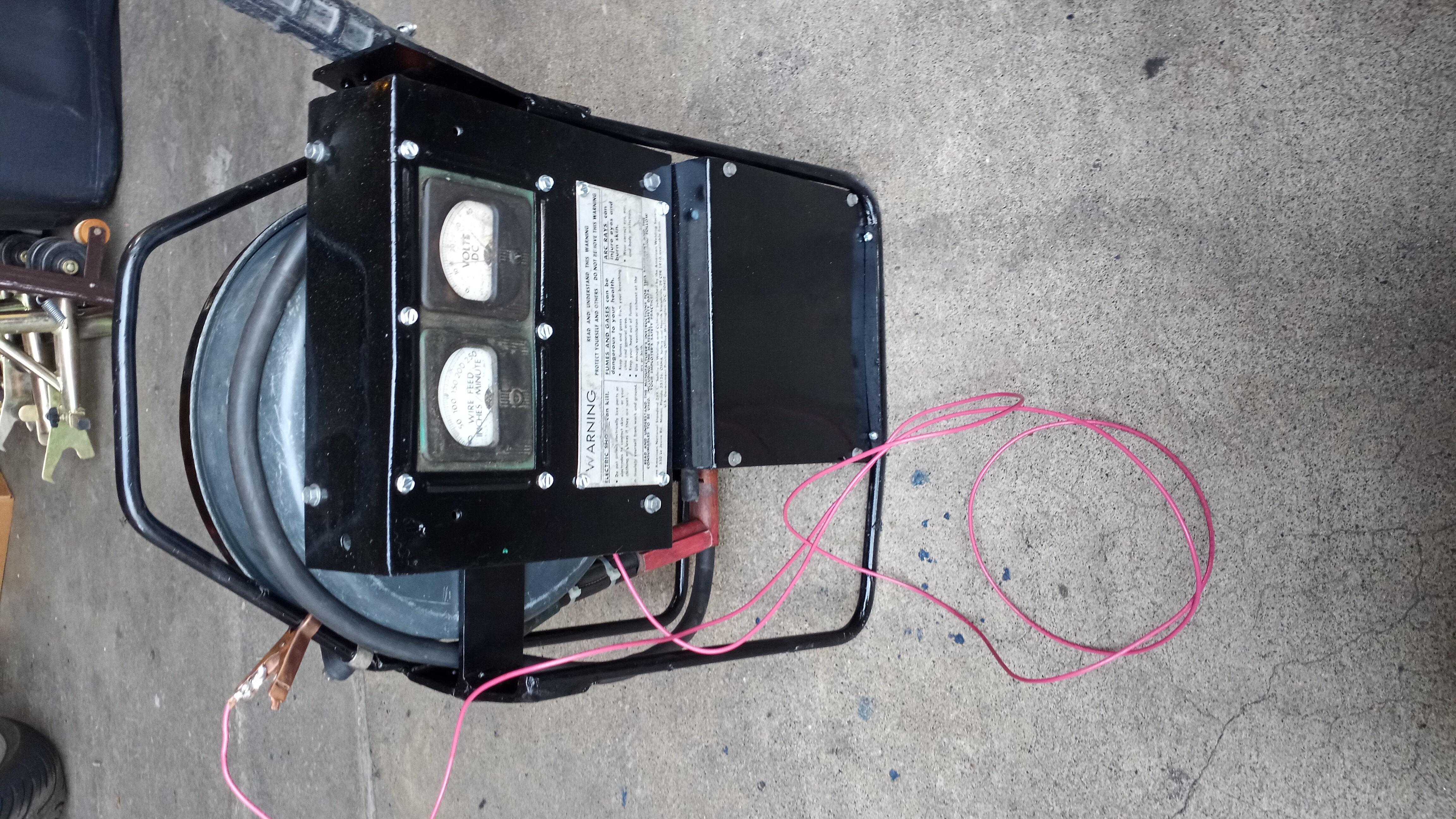

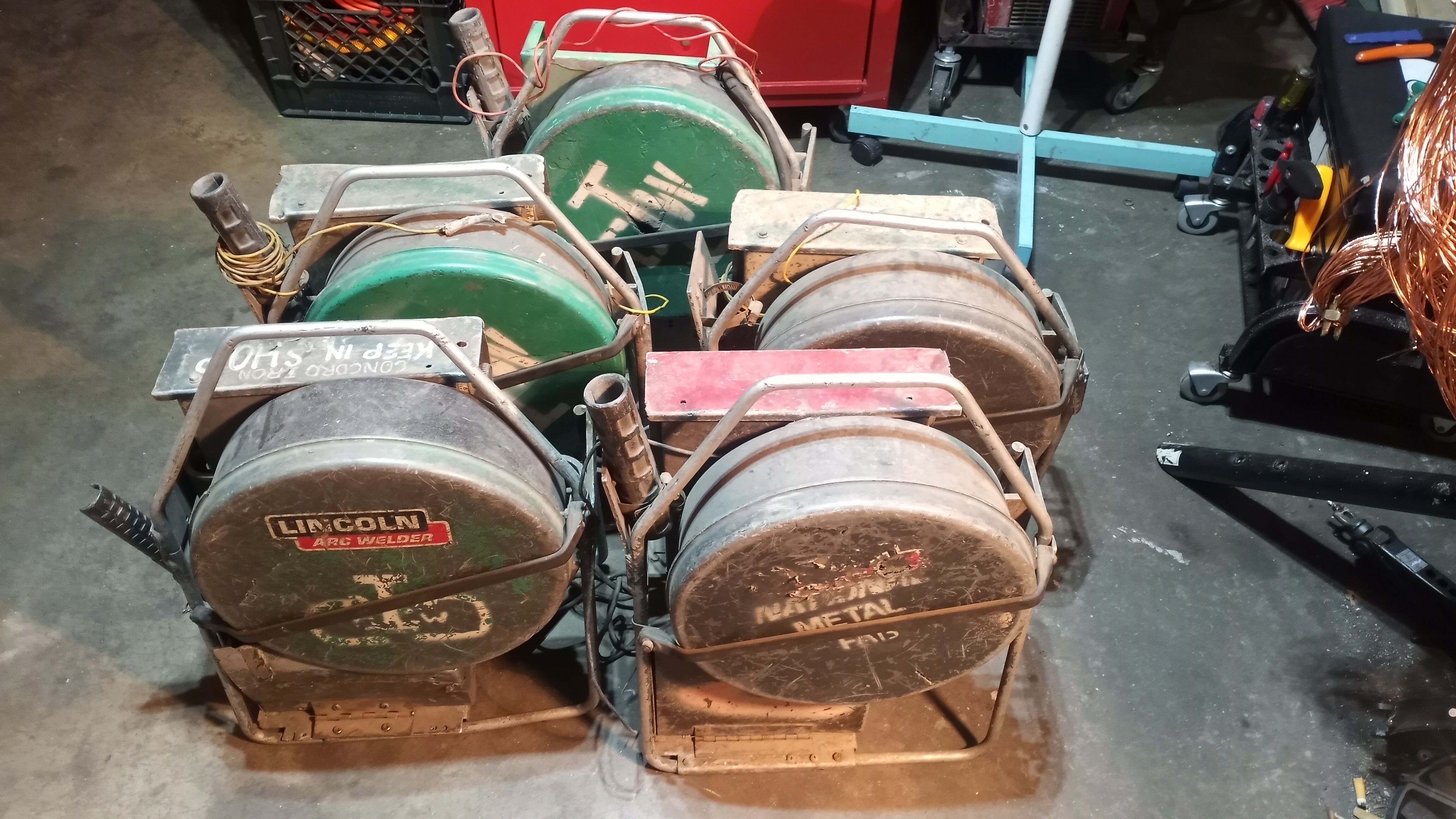

Now these are older machines and when i acquired them they were a bit worn out so I have taken the time to inspect these machines from top to bottom and service any components that needed attention. After servicing all 5 machines the only thing this entailed was replacing some worn out ellectrical wiring, a through cleaning, particularly inside the wire feed mechanism which was repacked with grease, and fixing a bit of damage to outer casings and framework. The gears inside the wire feeder were in remarkably good shape, see attached photos. Everything has been reassembled and tested and is in perfect working order. These are great little machines and are just remarkably durable and reliable. Pickup is available in the Sacramento area 95826, they cost about $100 to ship which i will charge as a flat shipping fee. My asking price is 400 per machine which i think is fair considering they wont need servicing for quite some time. I am open to offers/tradesName: 20210829_182955.jpg
