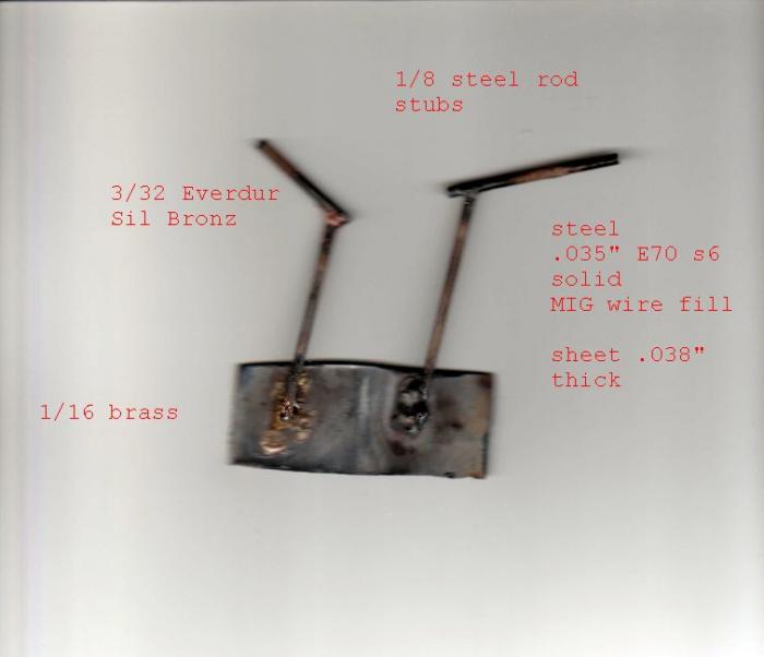

OK, the test.
O/A Genuine Smith Aircrafter torch, medium tip. Soft flame.
Round material is rod stubs from the bottom of a rod can where all good stubs are supposed to go, coating knocked off, light hit on grinding wheel. Sheet metal is scrap .037 mild steel that was galvanized before a light hit on the bench grinder.
Total elapsed time for test = 22 minutes.
Fillers tested
.035 E 70 S6 solid MIG wire
1/16 brass rod - NOT coated - light dip in Borax flux
3/32 Everdur (Sil Bronz) with slight dip in Borax
Sheet metal sitting on top of firebrick
Same with rods
Steel is a walk in the park. .045 gap between components is easier than contact.
Everdur is second easiest presuming you've run the material before and know the tricks.
Brass ia a pain in the ass. Works best if the components are buttered first.
No change in torch settings for different materials.
Post weld - hand wire brush only.
