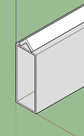

I have a project that requires welding two 14 foot rails that have a 1/4" by 1" X 1" angle iron on top of a 1/8" by 2" X 5" for each rail. The angle iron is mounted like an upside down "V" and is the track for a "V" caster. It is for the bed of DIY wood cutting bandsaw.
I will be using 1" tack welds every 6" on both bottom edges of the upside down "V" to mount it to the 2" by 5" box frame. I am not sure I can get what I need from the SP135 or I may have to go to stick.

Fred - with your unit, I’d at least run 0.30 wire with that material. You could also run Flux Core (DCEN) and probably get good results too. Even with 120v and 0.24 wire, for the strength you’ll need, you can probably do it. Use a push angle, slightly back from 90* to get a good fill.
