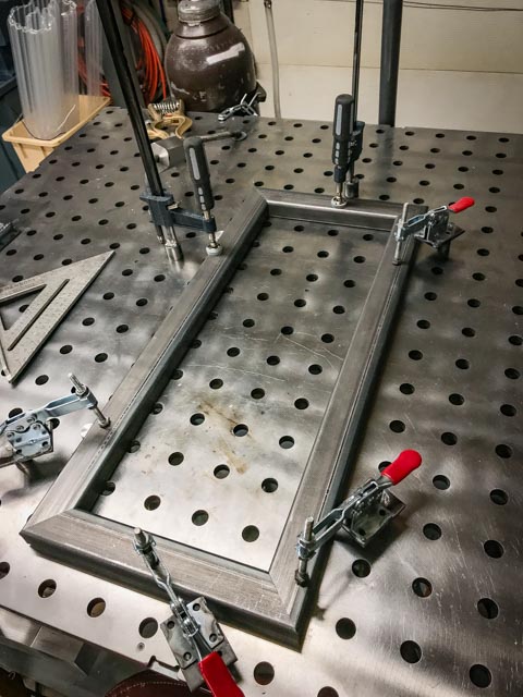

I'm interested in a welding table. A 2 x 4 Certiflat table looks interesting. Any one have experience with this?
Also where would I look for a kit of clamps that would work well with this table

My cert-flat table is one of the best thing I have bought for my shop! I haven't found anything I haven't been able to clamp down to weld. As far as clamps, make your own. Harbor Freight has what you need and it a good start. You just need to buy 1 1/2" X 3/16" flat stock and 5/8" round cold rolled and you're off to the races!

Here's my latest prototype clamp (modeled after Fireball Tool's clamp) used to reach areas where this clamp wouldn't reach.
