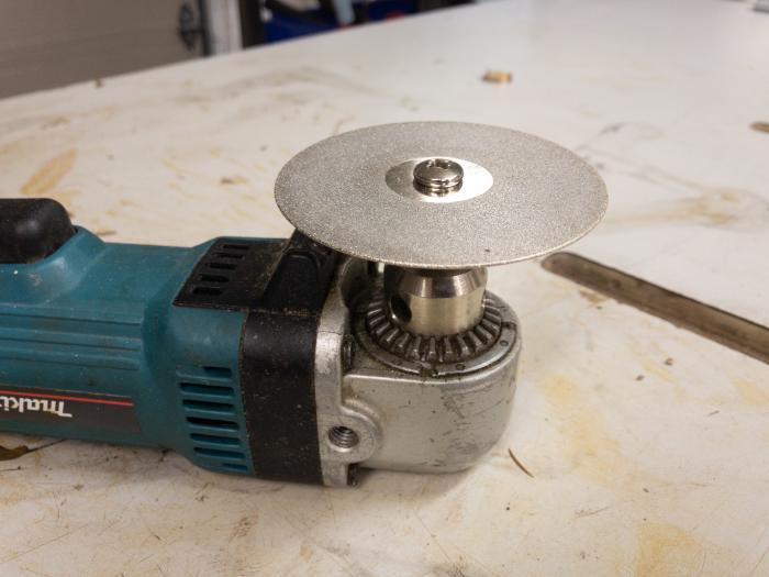

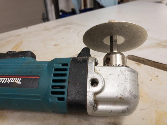

    Wed Aug 21, 2019 5:43 pm
    Cape Cod, MA
This is what I got from Amazon.
https://www.amazon.com/gp/product/B00CP ... UTF8&psc=1
Can't remember where I got the idea but it was from a welder.
Learning is the best part of life and the most painful
