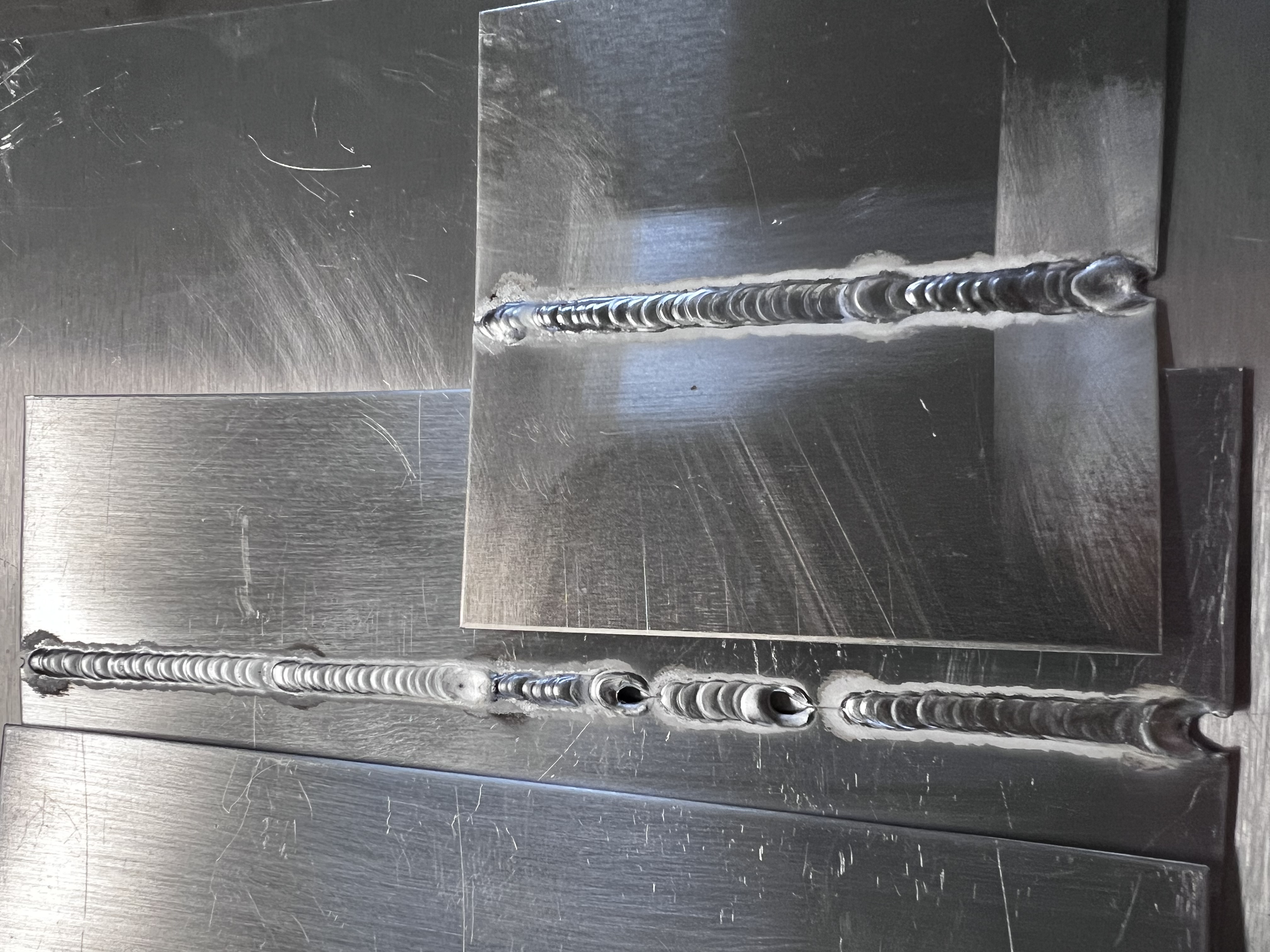

I didn’t catch your reply before I went at the aluminum again. This time a 1/16” butt joint @ 68 amps, #5 cup with 15 CFH, 3/32 blue and 1/16 ER4043.
Left to right. First attempt on the left. I popped a tack on the third try, lost my concentration and put a couple holes through the piece :lol:
I have a lot to learn and practice with aluminum ahead compared to stainless.

Thin aluminum is very tricky. You need to start backing off the amps as you approach the end to avoid the heat soaked material from burning back on you. Another trick is to add a larger tack at the end, weld to it, then back step to bring some of the tack into the weld.
68 amps is also tricky. It’s too much once you get going, it’s probably a bit low to start. If you have a pedal, set the machine to 80 so you get a puddle a bit faster, then as you go, start backing down the heat with your foot. You will get much better control with varying the heat than with a static setting.
Overall, pretty OK work! :D

Got it! I’m terrible at tacking aluminum. I’m on a pedal and going to crank it up to 80 as soon as I get back home later.
Re: New guy saying hi.
Posted: Tue Mar 12, 2024 5:45 pm
by Al_Bundy
@Cj737
I couldn’t edit the earlier post from today but here’s the result.
Padded a few beads at 80 amps, ~35-45% balance and ~120 Hz then tried another butt joint.
Feels much more fluid and controllable @ 80 amps but I definitely need to practice running beads to nail down my puddle width and tie-ins. I’m sure there are other things that my amateur eyes can’t see.
I broke the weld into two beads to practice my restart as well.
