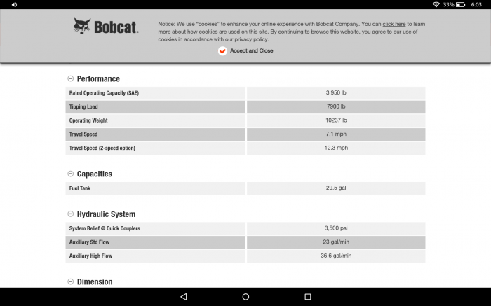

Bobcat s850aland wrote:I'd like to see a skid steer that can lift 6,000 lbs. 2500 is more like it for a skid steer.
3950 lift and carry
7900 tip
- Screenshot_2018-01-17-06-03-50.png (71.96 KiB) Viewed 4900 times

I wish our bobcat could 12.3 mph... And lift that much. Ours is an S205 so rated at 2050 lbs but I've lifted mini bulks with herbicide that are around 3000 lbs. the main thing is keeping the load tight to the loader as well. Ours wouldn't pick up our man lift because of the length of the man lift. Too much leverage in the front end. If it has fork holes on the side in sure I could have but too much weight 10 feet away from the loader it self wouldn't let it lift.MinnesotaDave wrote:Bobcat s850aland wrote:I'd like to see a skid steer that can lift 6,000 lbs. 2500 is more like it for a skid steer.

Pretty familiar with the most skid steers, and although the s850 spec says that, I'd love to see it in action.MinnesotaDave wrote:Bobcat s850

For reference, I own a Catapillar R-80 Rough Terriain forklift, it will lift 8,000 lbs, but it does that only on the 1st stage, so it lifts 8,000 lbs. to 10', not the full 30' with all 3 stages extended. Full height is more like 2,000 lbs to max height, and that is not tilted in any way.
Skid steers don't have multiple stages and are limited at the full extension of the lift, that would be no issues for a machine if you only need to live it a few inches, but to unload it you need to get higher as you need to get to the trailer bed.
Even still, let's just say the s850 will lift 4,000 lbs. to full dead lift. That is still quite a ways from a 6,500 lb. CNC mill.
Honestly, I wish a skid steer would lift more as I would trade my forklift for one, but I often lift logs with it that weigh 4,000 - 6,000 lbs. I don't think a skid steer can handle that and a good friend convinced me to give up on the idea. The other thing is the entire weigh of a skid steer, you need ballast when lifting. My forklift weighs 16,000 lbs. If you are not careful you can easily pull the entire lift over with a 3,000 lb. load if you tilt the mast too far forward. I have never lifted a machine that heavy, but my lathe weighs 4,000 lbs, and I've lifted it easily.
EDIT: Farmwelding you've got it right. Keep it low, keep it close, keep the weight down if you can.

I agree, the operating weight on that steer is 5000 lbs., however the tipping load is 10000 lbs. so that seems within the spec.MFleet wrote:I've done some checking and found that we used a Bobcat T870 to unload it. There was planning and a skilled operator to pull it off. That doesn't make it safe or right in any way. Don't do what we did.
Seems you got it moved and that is what counts. Thankfully nobody was hurt and the machine was not dropped in the process. I guess you can't argue with success, but it doesn't seem like a very smart move for a "skilled" operator, IMO. But my opinion means little. As I said, you got it moved and nobody was harmed.
