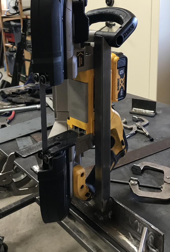

Quick follow up on this, I was just messing around yesterday and just welded two upright 1x1 square tubing on piece of angle. I made the height to catch the forward handle and then on left side I angled the square tubing to line up with the back of the saw. The back of the handle (behind trigger) basically rests right on top of the angle iron. For those wondering it really doesn't need anything on left side of saw as these newer cordless dewalts have a hanging hook and it butted up nicely right against that left hand side square tubing.
Again was just for playing around so the angle iron was simply clamped to the table. Kind of shocked me how stable it was so I think I'll use it for while. I added some scrap metal to build a base (sorry dont have photo of that one). Now I just need to figure out an easy attachment to give me a bigger working table to work material. I still use this thing a ton freehand so I dont really want to be screwing on/off the black support piece. If anyway has built a little easy to attach working table send me your ideas.

That's a nice little setup. I have used a Milwaukee portaband for many years with a Swagoffroad table. I sometimes use a miter gauge to help with angled and with 90 degree cuts, but I have had equal success with good layout and just cutting a ton of material to get the feel of the saw.
The biggest drawback to these saws is the lack of a blade support like a wood band saw that decreases the amount of flex in the blade. The way these saws are built, the blade will arch back and forth and can cut crooked. I mounted a lamp over mine to improve seeing my cut lines.
I buy Lenox blades off Ebay and generally use the 18/14 tpi for most of my stuff. The rule of thumb is to keep three teeth in the material at all times. Basically finer teeth for thinner stuff and let the blade do the work.
