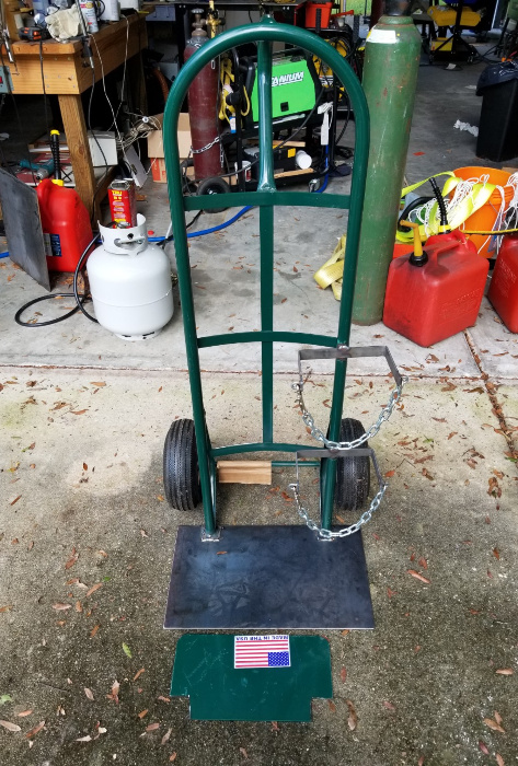

I bought a propane outfit, and I ended up converting a Home Depot handtruck into a cart. The welding carts I found online had tiny bases only wide enough for 7" bottles.

Thanks CJ, the challenge is that carts like that won't take a 20lb propane tank without modification.cj737 wrote:Google is your friend.
https://www.harborfreight.com/welding-c ... gI5l_D_BwE
My plan (at this point) at to basically cut my cart in half vertically and add in whatever width is necessary to accommodate both tanks, plus add some additional depth to hold the base of the propane tank.
My oxy tank is 7" in diameter, a 20lb propane tank is 12" in diameter, so 19" in total. Make it 20" for some clearance.
My hand truck is 16" between the wheels so I need to add 4" of width and maybe 3" in depth to the flat plate at the bottom.

Here is what I have so far. It wasn't hard at all. I cut the base of the handtruck away and replaced it with a bigger piece of plate that extends under a propane tank.
I still have not made a bracket for the propane. I am planning to use a rubber strap instead of a chain, since I own the propane tank and don't particularly want to take the paint off.
I'm going to paint the bare parts with truck bed coating. That stiff is incredible.
Harbor Freight sells solid rubber wheels for $7.50 each. The pneumatic tires are unbelievably stupid. Of course, they're Chinese, so they're always flat when you want to move the cart.

- 09 18 20 propane cart 06 mocked up with tanks small.jpg (223.75 KiB) Viewed 9344 times
- 09 18 20 propane cart 05 standing with new base attached small.jpg (221.62 KiB) Viewed 9344 times

Decided to put some tabs on the base of the cart to prevent the tanks from going anywhere. These weren't really needed, but what the heck.
- 09 19 20 propane cart 07 base plate with retaining tabs small.jpg (203.79 KiB) Viewed 9284 times

I finished the cart. I taped it up and used truck bed coating to cover all the bare metal. Hard to see in the photos. I still need a strap for the propane tank, and I'm going to buy solid tires and get rid of these ridiculous pneumatics.
- 09 21 20 propane cart 08 finished cart painted still needs propane strap small.jpg (230.34 KiB) Viewed 9211 times

I got rid of my pneumatic tires. Today I bought solid wheels from Harbor Freight, and I put them on the cart. The offset was not the same as the offset on the original wheels, so I made spacers on the lathe.
I think this thing is basically done, although I would like to come up with some kind of fork to hold the torch.
- 09 21 20 propane cart 11 wheel spacers finished small.jpg (140.07 KiB) Viewed 9161 times
- 09 21 20 propane cart 12 wheel spacer on axle small.jpg (156.68 KiB) Viewed 9161 times
- 09 21 20 propane cart 13 wheel spacers on cart small.jpg (179.01 KiB) Viewed 9161 times
