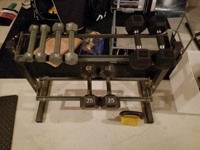

My first project was to weld up a dumbell rack, which went reasonably well, but I did the cutting and grinding in my garage with abrasive wheels on a chop saw and angle grinder, as well as a flap disc. I wear all of the required PPE, such as respirator, safety glasses, face shield, hood when welding, ear plugs, welding gloves and an FR hoodie...I could/need to invest in a leather apron.

As for the rack, I really want to try some destructive testing, but it is also nothing that would put me at risk in terms of injury as it's not like a squat rack or bench press that I'm getting my body underneath. I've put the heavier weights on the bottom rack that are 8" off the ground. I put my full body weight and jumped up and down on it, haha. Me and the fiance are slowly buying weights because all of the gyms are closed around us.

I see you used angle iron, and now understand the "rack". Yeah, that looks plenty safe. I was thinking squat rack or bench press type equipment. Good on you, that rack looks solid, safe and came out nicely.As for the rack, I really want to try some destructive testing, but it is also nothing that would put me at risk in terms of injury as it's not like a squat rack or bench press that I'm getting my body underneath. I've put the heavier weights on the bottom rack that are 8" off the ground. I put my full body weight and jumped up and down on it, haha. Me and the fiance are slowly buying weights because all of the gyms are closed around us.

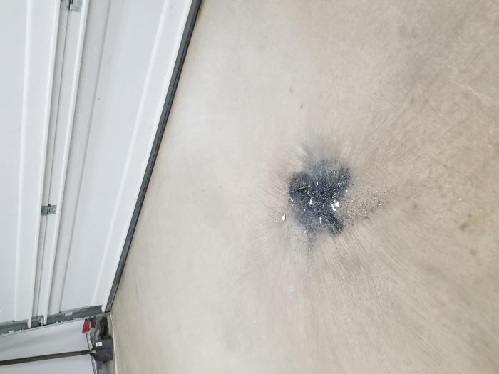

This little combo did an amazing job! At least 28 cuts later, got this 2x2x125 square tubing cut for ny next project, which will be my work / welding bench.
This is a 7 1/4 10 amp Ryobi compound mitre saw with a Diablo Steel Demon blade. After all those cuts, the blade needs to be honed, but not bad for $200 Canadian (saw and blade). The saw didnt skip a beat, though now has a few battle burns.
This won't replace the long lasting blades of cold cut saws, there are way more sparks than those cold cuts, but the metal dust is mostly shards and leaves clean edges! This combination also cuts quick. This is a viable option for those of us who do this as a hobby with no production welding or cutting.
I enjoyed this WAY more than the abrasive saw and angle grinder
Off to get the blade honed now, lol.

That saw still turns way too fast IMO, even if it less than the RPM limit of the blade. You should not need to hone the carbide teeth after so few cuts. The ideal RPM for a 7¼ " metal cutting blade is about 2,500 RPMs. Does yours have the titanium carbide tips on the teeth, or the Cermet II tips?
You guys are right. This definitely isn't an ideal use of this saw and blade combo. I knew it was a compromise and that a proper cold cut saw would have been much better, but they're not widely available here. Princess Auto (Canadian version of Harbor Freight) used to sell one for pretty cheap, but it's no longer available.

So I did some quick math based on rotational speeds of a 14" dry cut saw vs my 7 1/4" miter saw. At 1600 rpm, the linear speed of the dry cut saw cutting tips would be ~11,200 inches / min. My mitre saw, assuming a loaded rotational speed of 5,000 rpm, the linear speed of the cutting tips would be ~18,125 inches / min. Or 1.6 times faster than the dry cut saw.
So, definitely not optimal, but despite the rotational velocity being > 3 times that of the dry cut saw, the teeth are only moving 1.6 times faster. If course there are other variables, such as fewer teeth and smaller blade area, so the blade and teeth would heat up WAY quicker on the set up I used yesterday.
