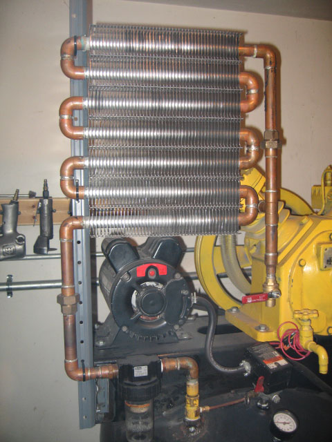

What about using an intercooler to reduce the moisture?
(Cooled air causes the moisture to form into droplets.)
My air compressor has a finned copper loop directly behind the cooling fan.
I believe the idea is to cool the hot compressed air before it reaches the tank.

A cooling fan over this radiator would make this setup much more efficient.
A thermostatically controlled, electric fan from from a vehicle would work great.
echosixmike wrote:Google "Franzinator" if you want to make an expansion air/water seperator. If you want to follow that up with a chemical dissicant, it'd probably be near perfect for anything less than lab or commercial use. S/F.....Ken M
- Intercooler.jpg (76.28 KiB) Viewed 4135 times
