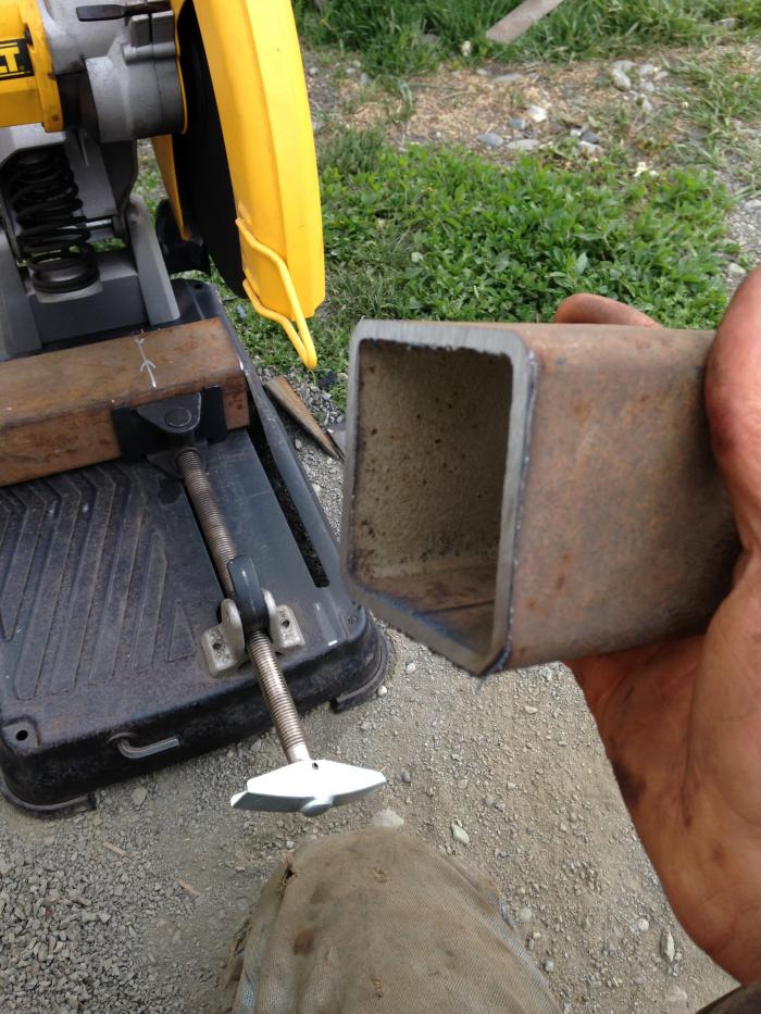

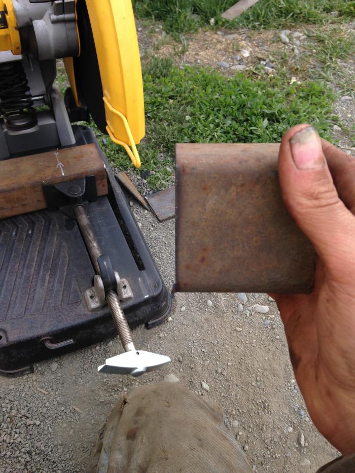

I've done tons of cutting with my dewalt 14" abrasive.
Allow me to share some pics.
~John
3"x3" square tubing, 3/16" wall.
    Wed Oct 23, 2013 3:30 pm
    Palmer AK
2"x2" angle, 1/2" thick.
Always cut angle facing down.

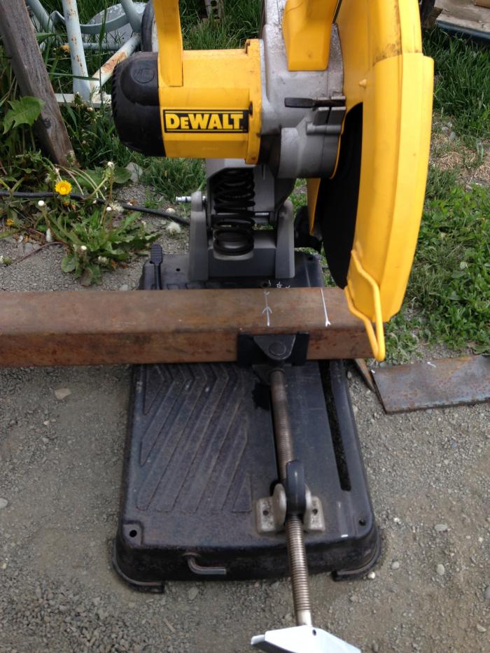

Like this!!!!
    Palmer AK
That being said, don't do miters, just cut straight stuff.
Does great cutting anything straight....

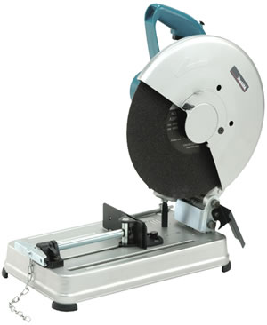

I just saw a Makita 4131saw and also a Metal cut off saw Model LC 1230.
I as yet have not had chance to look further into either of these saws so any info would be greatly appreciated.

As a follow up from my previous post this is the blade i saw on the net.
Have any of you guys used this blade or have any comments on it. I need something like this for our Workshop in preference to a porta band.
I saw somewhere that they had a 100 tooth blade but am unable to find one. The blade in question has 60 teeth.
