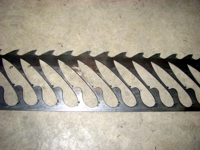

Whacked some neck knives out of a .050 thick bandsaw blade today also. These sharpen up like a mad womans tongue. I use a water table on my CNC so heat is not a problem. No heat treating needed on these as long as you don't get them hot while sharpening.
- band saw blade.jpg (58.36 KiB) Viewed 3138 times
- necker.jpg (50.41 KiB) Viewed 3138 times

hmm. Have you some plans about rest or just throwing away with trash?

The left overs from cutting (the skeleton) goes out the back door onto the top of the scrap pile which is getting tall enough that I need to start another pile!
