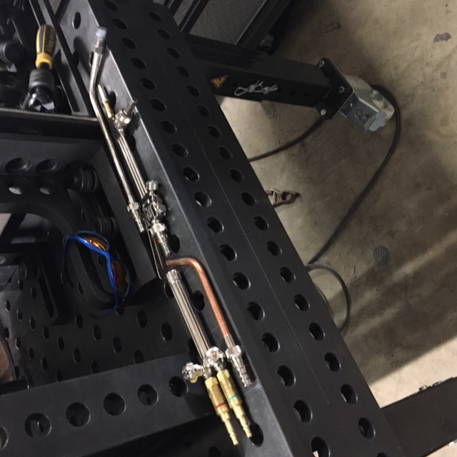

Based on your requirement to not/not OFW, strongly encourage you to consider Oxygen-Propane. Oxy-Pro is ideal in your situation, as you need the rig to preheat, cut, and shape. Oxy-Pro is less expensive to run over Oxy-Acet, safer to stow/operate, and easier to fill. Oxygen-Propane has been used for decades to sever steel 4+ in thick.Chips O'Toole wrote:....I am not very interested in acetylene welding....I would like to get a decent American product....
Although we prefer Oxy-Acet for Flame/Heat Straightening, Oxy-Pro does fine with the proper technique. Oxy-Acet also trumpfs Oxygen-Pro for Brazing due to the heat intensity and location of Acet's primary flame.
As far as manufacturers, we've ran lots of setups and still prefer the Smith/Miller torches. Solid construction and finish, three-tube design, SS ball valves. Supported by the majority of LWSs and online resources, lifetime warranty, and Made in USA.
Specifically recommend the Smith/Miller Medium Duty Oxygen-Propane Kit. The kit retails for ~ $400. With an extra Cutting Tip [MC40-0], Brazing Nozzle [MW411], and SafeMate FlashBack Arrestors/QDs from Western Enterprises the total cost of ownership should approach $550.
You can easily design/fabricate your own mobile cart, to include integration of a 50lb propane cylinder and 135CF Oxygen.
To support any follow-on discussions of flame "temperature" vs "heat capacity" in comparing/contrasting Propane and Acetylene, the images below show the adiabatic temps and heat concentration of commonly used oxy-fuel gases. Note, Propane has a higher stoicometric Oxygen requirement than Acetylene, and therefore Propane's consumption rate of Oxygen is roughly three times that of Acetylene. Thus, if you go will Propane definitely acquire a large O2 cylinder.
PM me if you have any specific questions regarding this setup.
Administrator: images captured in 'Square' format a la Instagram. CW rotational assistance appreciated.
