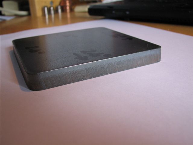

With Hypertherm air plasma cutters you could call the hand cutting shield a "standoff guide". When it is dragging on the material the arc length is correct, and since it is electrically insulated from the nozzle there is no stiction. When you switch to the machine cutting shield it is expected that the cnc machine has a height control system (arc voltage feedback) that maintains the correct standoff. Plasma cutters need to maintain the correct arc length for best cut quality...an auto height control that works properly will hold the arc length to .060" (Hypertherm spec for most materials) within plus or minus .004" (1 arc volt). You cannot possibly do that by holding a standoff by hand...that is why the shielded technology works so well for hand cutting. Jim Colt Hypertherm
With correct height and machine cutting...here is what 3/8" steel cutting looks like:
- Powermax45 edge angle 003.jpg (28.45 KiB) Viewed 7054 times

@jimcolt, wow! I would have sworn that was laser cut! I guess the key words are "proper setup and technique"
