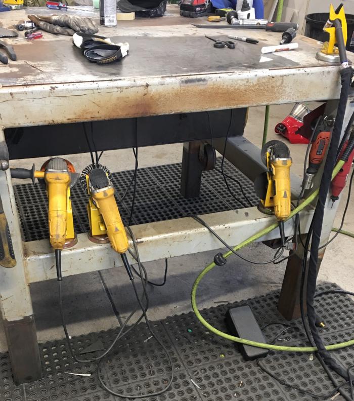

What’s up everyone, so I have a question for those of you who have or have used cordless grinders. All mine in the shop are corded dewalts and every now and then I have to move them around the shop to cut something small or grind something and I’m thinking of buying one cordless. I already have a nice Milwaukee drill I use daily and I am leaning towards Milwaukee so I can use the batteries interchangeably. Can any say what brand they’ve used and what seems to hold up best in their opinion? Thanks for any input. Here is my current setup!
- FF3E7A58-0AAA-4187-A0C0-E29E3E34BDF1.jpeg (103.92 KiB) Viewed 7633 times

Since you already have a Milwaukee battery go with the Milwaukee grinder.
Theres not a lot of difference between the top 3 or 4 battery tool producers in terms of performance and quality, so go with what youve got.

May as well go with the Milwaukee. You've got batteries already. I've only used the dewalt cordless grinder and it is the nadir at tool on the farm. Use it almost every day for anything you can think of. This last year we upgraded and got the conversion kit to use the 20v lithium batteries and now they cut like a hot knife through butter. If you can get the higher amp hour batteries.

They have both Dewalt and Milwaukee at work. They both a seem to work fine. I’m just not a fan of having to stop working on something to change batteries or worse yet waiting for one to charge. But they do have there place with small jobs. They also seem to be hard on batteries
I like my milwaukee 18v cordless grinder.
I bought it for a vinyl siding job and it cut that stuff most of the day on one charge.
On steel the cutting wheel doesn't suck the battery too bad but a grinding wheel can put a hurt on a battery
Can't lean on them like a corded version or it'll stop until you pull the trigger again.
Overall, wish I had 2 or 3 of them

I have all Dewalt 18 volt cordless tool. The 4 1/2" grinder works OK but like said its hard on battery's if you really bare down on it. Now flap disc's and cut off wheels seem to do a lot better. I keep 4 battery's charged all the time.
Thanks for the input, probably pick one up later this week. I’ve used the dewalt ones at previous employers and liked them but never really thought it would benefit me much in my shop since I have plenty of outlets, but those few times when I just need to do something quick it would be nice just to grab it and go. I use my current ones pretty much daily.

I'll also add that with a wire brushes, especially cup brushes, they work well because the spin at a lower rpm so they don't grab as bad and don't vibrate as much.

You know what they say about opinions. For the cost of one of those pieces of shiite I can put receptacles avery six feet from one end of the shop to the other, on both walls, and not have to deal with the battery scam. In the field on a scaffold or where there is no electric is one thing. In a shop is another animal.

Sorry I thought I put in my original post that I wanted it for little odd jobs that require an extension cord in or outside the shop. I guess I didn’t. I’ve used the dewalt cordless grinder at a previous employer and it worked very well. You must have had a bad experince to call them a scam. I did end up picking up a Milwaukee fuel grinder and it came with 2 batteries. I will put it to use and post up any feedback if anyone is interested.Antorcha wrote:You know what they say about opinions. For the cost of one of those pieces of shiite I can put receptacles avery six feet from one end of the shop to the other, on both walls, and not have to deal with the battery scam. In the field on a scaffold or where there is no electric is one thing. In a shop is another animal.

Ok so after a weeks worth of use I have to say I’m pretty happy with it. I put it through it’s paces and with the 5.0 batteries it lasted a good amount of time. It feels just as strong as my corded grinders, of course it’s a little slower RPM but still easily gets the job done. Like I said before this is for quick little jobs in and outside of the shop and I have no doubt it can handle what I’m going to throw at it and I don’t regret the purchase.
I don't regret mine either - and 10 years ago I would have actively rejected anything battery powered except drills.Graveyard wrote:Ok so after a weeks worth of use I have to say I’m pretty happy with it. I put it through it’s paces and with the 5.0 batteries it lasted a good amount of time. It feels just as strong as my corded grinders, of course it’s a little slower RPM but still easily gets the job done. Like I said before this is for quick little jobs in and outside of the shop and I have no doubt it can handle what I’m going to throw at it and I don’t regret the purchase.
... I'm even thinking about adding a cordless circular saw for carpentry this summer... And a second cordless grinder for mobile work. One for grinding, the other with the wire wheel. The fewer cables to drag around equipment the better
