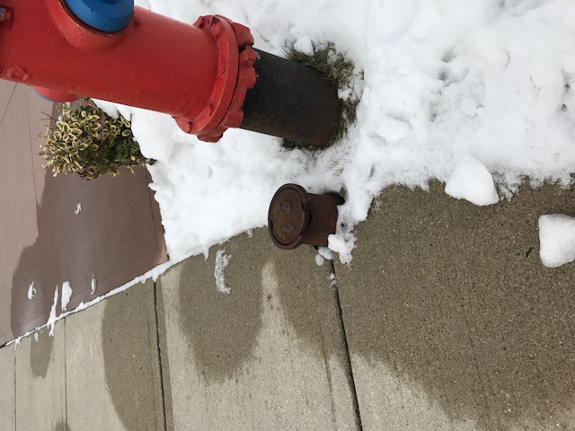

Hi! I have very little knowledge about metal cutting and would like to throw out a question for the experts... I need to determine the most effective way to cut eight 5/8" diameter bolts from the base of a fire hydrant body where it meets the breakaway flange. I will need to repeat this hundreds of times. I've used thin 5.25" cutting discs with success in the past however I'm looking for other/quicker alternatives. I have the option to cut bolt heads off, cut the nut off or in between the flanges. I will attempt to attach a couple pics of the typical scenarios. I'm curious about whether plasma cutting would work well in this case. Thanks for your input!
- McAvity.JPG (150.75 KiB) Viewed 4380 times
- Darling.JPG (98.43 KiB) Viewed 4380 times

I agree blue tip wrench !Poland308 wrote:Just blow the heads off with an oxy acetylene setup.

I agree, Oxy fuel would be fastest, maybe 10 seconds per bolt tops. Plasma cutter isn’t as easily portable in my opinion, and for 5/8 thick steel it might struggle whereas the oxy fuel wouldn’t hesitate. I’d chose oxy hands down.

Heating them up and unbolting them would work but you would use a lot of gas. I would go with as already suggested cutting with the gas axe. I can offer one more suggestion get yourself a rivet cutting tip for your torch, it will allow you the get more of a flush cut. https://www.youtube.com/watch?v=z5O8KA9YnRM

Thanks to everyone for sharing your thoughts!
The idea for these hydrants is to remove older fire hydrant bodies that have only 2 side ports and replace them with 3 port hydrant bodies. The third port is larger and has a quick connection fitting called a Storz port. Local fire department has requested that we attempt to transition to 3 port hydrants. Our plan is to reuse/recycle 3 port hydrant bodies whenever possible and when the 2 port hydrants are otherwise in good condition underground.
