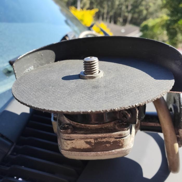

Thanks always for the replies. Pics will tell the story better. Now I am thinking it's nothing more than the inner flange is too worn out, but not sure if getting a new one would solve it, as it would take a lot of material to bring it back up to where this all would work.
Below (bottom pic) is the bare inner flange. It can only go on one way as there are little cut-outs on it that match up with the notches in the grinder shaft so it all is locked and spins together. The issue is that the inner section of this flange in the centre that rises up, is too high. To properly fit, the flat surface that the disc rides (the worn chewed edge bit) would have to be at the same level or at least much nearer to the top of the inner centre section.
But as per the second pic, it isn't and with the outer flange wound on, the gap between the flanges is still too big, because a combo of the inner flange disc riding surface being too low and the outer flange/locknut recessed side not being recessed enough. You can sort of see the gap in the first pic. Flipping the nut upside down from this pic makes it worse because the inner 'ring' of that nut actually sits higher than the outer 'ring' (hard to see from the pic).

I've seen this problem, but a different nut resolved it. The arbor has that section raised, one thing you could try to putting a washer under the disc to raise it up above that section, then tighten the nut down. Your other option is to get the threaded hub cut-off wheels. Or yet another option, get a disc with a smaller bore in it, one that will fit over the threads but not the metal section. What size is the threaded arbor, and what size is the metal at the base?

You need to replace the nut set to one that’s capable of using thin wheel. That set is only for 1/4 inch thick wheels. You need a lower nut, (the one closest to the grinder) that is flat. I’ll post pictures of the ones I use. You just flip the top nut over if you swap between thin wheels and thick, or flap discs. They even work good with the .040 thin wheels.

Well I took the machine and disc into a higher-end tool shop a couple of days ago and it turns out they had inner flanges in stock. I thought I might as well get a new one so I could run the thick discs ok, as the old one was pretty worn and then I could move onto to sorting out the thin disc issue. But I wasn't thinking it would fix the problem, as it would just be the same dimensions as the old one but in new condition.
Turns out it did! Below is a pic of new vs old.
The guy at the counter test-fitted the thin disc and said good to go and also interestingly told me that the outer flange/lock nut DOES NOT need to be cranked down super - tight. He said they tighten up a bit when in use and all that's needed is a secure tension with the pin wrench but def not a crankdown like your life depends on it. I have always done the opposite and this prob contributed to the wear on the inner flange. It looks like a fair chunk of the inner flange's thickness / height is some sort of rubber bonding that may help with gripping the disc and reducing shock and vibration and over time it will wear down anyway, but I may have sped up the wear rate by overtightening over the yrs.
Anyway, test drove it on a 2 inch cut thru 4mm gal plate and it worked a treat with no heat marks less sparks and def faster and lighter than the 2.5mm disc. Came away pretty stoked and thanks again for all the help.
