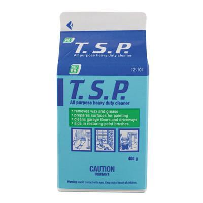

Take the wire wheel off of the motor, and soak it in a solution of TSP overnight, then rinse it off in the morning.
TSP is found at most hardware stores and some grocery stores. Add water to a small quantity of this BASE powder.
Follow the directions on the package and wear safety goggles and gloves when using it.

I think TSP is a great option for an end-of-the-day cleaning.
I also think the (yes, non-chlorinated) brake cleaner is a great option for periodic cleaning through the day, but a potential fire hazard, as it's best used with the wheel spinning. Assuming you have a full size stone on the other end of your grinder (to serve as a flywheel), you could come up to speed, kill the switch, unplug the grinder, and spray brake cleaner from the side into the wire-wheel where the wires meet the hub. The combination of centrifugal force and solvent should throw the crap off the wheel nicely.
I would add, with the TSP cleaning at the end of the day, I'd also clean the crap off of the shroud and guards.

Couple of quick questions now though. Has anyone heard of anything similar to the poisoning that happened with the break cleaner happening with the TSP? Or, is it just safer and a better option to use this over break cleaner?

Michael, I'd think oven cleaner would be out for two reasons... First, it takes a while to work, and second is highly alkaline making it as dangerous as an acid.
TSP is essentially harmless... If it were used for a thorough cleaning at the end of the day (or once a week, if the following suggestion works), it should be rinsed. Additionally, the brake-cleaner caution does not apply here... The wheel will dry almost immediately with no residue, and as long as you use "non-clorinated" brake cleaner, there is no hazard at all... I use it all the time. You can't make Phosgene without chlorine.
