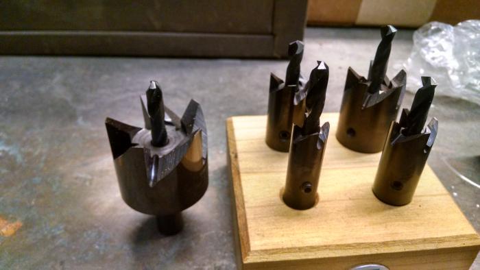

I am trying to notch 1" stainless .065 wall tubing on my drill press and keep breaking the teeth off of the hole saw. I have the drill press set to the lowest rpm. A machinist friend said I would need a mill to do this to get the rpm down lower. Can't afford that purchase right now. I am using bi metal hole saws at the moment. Any recommendations from anyone on better hole saws or techniques ? Thanks.

I use some carbide cutters from Michigan drill that work excellent on stainless, hold up very well. Like a hole saw on steroids...

The set I have is HC690S they sell bits individual...
Hc690 1 is what you'd want

Where could I source those bits?

Steve, youll love these, I can drill a 1.50" hole slide a tri-clover ferrule in and weld...it's that nice of a hole. Here's a link to the web site I know they have a 2" you'd have to call for something larger. I use a lot of lube and they hold up very, very well.Otto Nobedder wrote:Rick_H,

http://www.michigandrill.com/search/index.php?s=Hc690
Excellent! Thanks! My most common "off square" hole is 1 7/8" to insert a 1 1/2" pipe nipple.Rick_H wrote:Steve, youll love these, I can drill a 1.50" hole slide a tri-clover ferrule in and weld...it's that nice of a hole. Here's a link to the web site I know they have a 2" you'd have to call for something larger. I use a lot of lube and they hold up very, very well.Otto Nobedder wrote:Rick_H,
