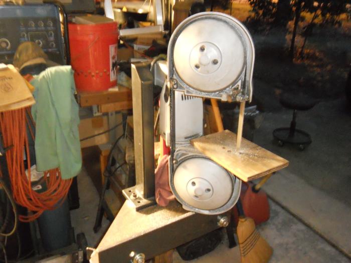

Can't beat the versatility of a portaband...that is if most of your work is small. I first made a swingarm for mine for use as a horizontal. This is my latest creation for it:
The plywood platen for it was a "get me going" thing, but so far it's done everything I've needed. Only thing I'd like to add would be a series of grooves to give somewhere for the swarf to go, rather than bunching up and potentially scratching my work. Anything important gets masked up with tape.
Best advice though to buy based on your needs.
