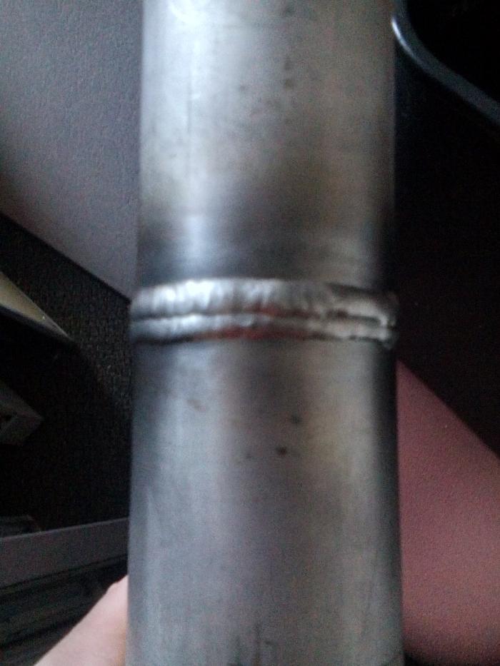

With this one I ran the root with 3/32 gap and rod,heat at 60. Cap was 55 with 3/32 rod. I still burned through in some spots though. I tried the 1/8 rod at 75 like you said but burned through big time. After the root I let it cool to the touch
and after each stringer I let it cool to the touch. But the cap on this looks a little cold.

ive been running the wrong filler metal. Ive been running 309 when I should be running 308. : /
Okay, that is not the appropriate filler, but the behavior is going to be so nearly identical to 308 that your performance should not change noticably going to the correct rod.joshuanaaa wrote:ive been running the wrong filler metal. Ive been running 309 when I should be running 308. : /
