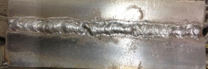

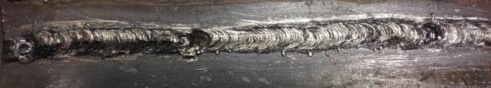

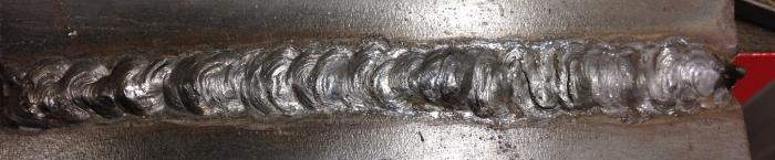

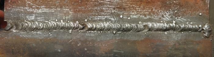

Hi,
I'm looking for opinion guys as in the title I'm going to challenge my tests in Calgary. Do not have much experience with stick but have to improve as there is one month to do so. Trying to weld 3G at 45 degrees up hill.
I would like to get some opinion and advice on what you see. (did not clean the welds very well)
![Open butt 3/8 plate, 3/32 opening and landing, 3/32 E6010, about 60A, welder set for stiff arc](./download/file.php?id=8391&sid=34635a4f15e5dbd1cd8739e5db3536e3)
- Open butt 3/8 plate, 3/32 opening and landing, 3/32 E6010, about 60A, welder set for stiff arc
- IMG_33191F.jpg (65 KiB) Viewed 3329 times
![Hot Pass at about 80A, 3/32 E7018, welder set for soft arc](./download/file.php?id=8392&sid=34635a4f15e5dbd1cd8739e5db3536e3)
- Hot Pass at about 80A, 3/32 E7018, welder set for soft arc
- IMG_33241F.jpg (63.77 KiB) Viewed 3329 times
![Cap at about 75A, 3/32 E7018, welder set for soft arc](./download/file.php?id=8393&sid=34635a4f15e5dbd1cd8739e5db3536e3)
- Cap at about 75A, 3/32 E7018, welder set for soft arc
- IMG_33301F.jpg (53.19 KiB) Viewed 3329 times
Thank you
Slawkos
Re: Red Seal tests
Posted: Sun Jan 17, 2016 7:14 pm
by plain ol Bill
Practice a LOT more.
Re: Red Seal tests
Posted: Sun Jan 17, 2016 7:36 pm
by Poland308
How thick is your plate? Is it beveled? And what kind of rod are you useing?
Re: Red Seal tests
Posted: Sun Jan 17, 2016 8:25 pm
by Otto Nobedder
All right, Slawkos,
You have one month... If you hope to pass your Red Seal, you will be busy all month. You've established the basics, but you have miles to go before you sleep.
Details and pictures, and more details and more pictures.
You CAN do this. You can find extensive help here.

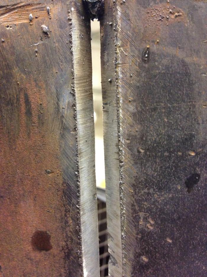

It looks like I need some kind of magic cos I can practice only about 2-3 hrs 2 maybe 3 times a week. No access to workshop and gear.
All details are underneath each of picture, repeating as follow:
Welder is Miller CST-280 (I forgot to say)
The root is done whipping rest is weave. Every weld with no push nor drag.
Open root - 3/8 plate about 37degrees, 3/32 opening and landing, 3/32 E6010, about 60A, welder set for stiff arc.
Hot Pass - at about 80A, 3/32 E7018, welder set for soft arc
What do you think about use of 1/8 E6010 75A fallowing Jody's video for the root. (I have used 3/32 as is handy for me) I know he's doing 3G and my is 3G inclined 45degress. Maybe just to do stringer instead...
I know I need to practice a lot specially stop and start on root pass as I'm leaving big unfused gap.
Below more of pictures from last Saturday.
Parameters very same as last time maybe I have set root a bit hotter some 65A.

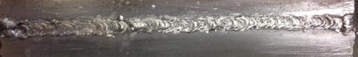

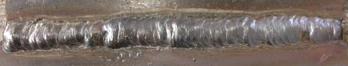

I have moore pictures just from today. This time I have practice 4G. The same plate as before, opening, angle, landing, electrodes also same.
The amperage for root was 65A and rest about 85-90A. I have run it stringer, and rest weave. Slight drag angel on all welds
Have a look
Arrow shows the stop start of weld

Re: Red Seal tests
Posted: Tue Jan 19, 2016 8:00 am
by Poland308
60 amps on an open root for 6010 seems a bit cold i would bump that up. Try turning it up 2 or three amps at a time. I noticed in some of the pics your not getting concistant root tie in. I like to run my root with very little whip and when you look at it as you weld it needs to feel like your sticking the rod all the way through the gap. But it does look like your practice is starting to do you some good. Ive used a 280 CST for a lot of work.
Re: Red Seal tests

Re: Red Seal tests
Posted: Wed Jan 20, 2016 7:48 am
by Poland308
If you go with no land you will find you end up blowing through a lot. I use 1/8 in 6010 at about 70-75 amps. 1/8 in land and a 3/32 gap.

Re: Red Seal tests
Posted: Sat Jan 23, 2016 1:33 pm
by Boomer63
Hi Slaw! I teach welding at a college, so let me put in my two cents ... or what ever exchange equivalent that works out to be!
You are learning. When teaching, I sort of deal in percentages of the weld, based on the experience/skill level of the individual welder. For you, a beginner, from a cold start with no background, I would say you are getting better than 70% of your weld correct, which ain't too bad. My opinion is that the 100% capability comes with years of experience. A very seasoned pro KNOWS he is going to get that weld exactly right, and doesn't worry about - or at least doesn't worry about it too much. Beginners, those with LESS THAN 4000 to 6000 HOURS of experience, usually can't perform at that 100% level; which is why they typically aren't expected to do critical welds.
Now, I know most guys don't think in terms of the percentages, but it think it helps explain how a guy can do a weld 'perfect' on one pass, and only about 3/4 'perfect' on the next pass. Add the two welds together and you get that 'percentage', which I think really tells you where you are.
Welding is not easy and takes years to really master. Yeah, I am going to be nervous taking a test for a job, but chances are that I will do just fine and pass; I can't remember the last time I failed a job test. But I know that I have failed, and if I were taking a lot of these types of test, I might fail again!
Keep practicing. Be patient. Don't compare yourself to other welders, everyone is at a different level, but if you stick with it you all pretty much up up at the same place. I would say that for the amount of time you have been welding, you are where you should be. I understand you want to do much better, but have confidence and don't give up!
Gary

Re: Red Seal tests
Posted: Wed Jan 27, 2016 11:53 am
by Boomer63
@Slawkos - Thank you for your compliments!
Obviously, some of your welds are better than others. Make darn sure of you position before you strike up any arc. I used to have a checklist - literally a list of things to do and how to set up - written out and taped to the wall of my booth. You must be in the same position everytime you do this. Obviously, you won't be able to do that in the field, but this is not the field, this is a test you are trying to pass. I think you have enough skills to pass this test, with a bit more practice.
One other thing I would suggest is that you run short stringers. Stop and evaluate what you are doing. If it looks good, keep doing that. If it don't look good, then change it until it does. Don't run long stringers or stringer after stringer the wrong way; all you are doing is teaching your body the wrong way to do things.
Good luck! Your skill will carry you through!

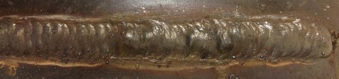

Today I was doing 2G GTAW open root on 3/8 plate, 37degrees bevel 1/8 opening no land, 1/8 rod (did not have any rods so used bare E7018 wire). The passes was SMAW E7018 1/8".
The story is that the cup was too big no7 it could not fit in to the grove (didn't have any other), and the tungsten 1/16" (way too small)
![Neutral :|](./images/smilies/icon_neutral.gif)
I have set the machine for 90A to have nice heat and have to have long stick out because of the cup. Ending up with burned tungsten and pores (could not have more gas flow because of turbulences) the whole weld looked like after battle
![Evil or Very Mad :evil:](./images/smilies/icon_evil.gif)
anyway have a look yourself

You should abandon any idea of using bare stick rods for GTAW. All stick rod wire is low quality steel, all the good stuff is in the flux, you will end up with crap results as per your pic. GTAW wire is high quality filler with deoxydisers and additives. Using anything else is just a waste of time - especially when you are learning.

and now using 1/8 with about of your amperage for the root and short arc as well the passes are about 110A. It would be too hot for me for the 'z' wave with the 3/32s
Thanks for sharing any suggestion counts and is very welcome
