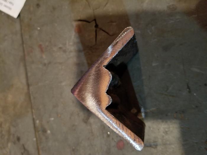

I am practicing 7018 uphill on a piece of angle iron. I am starting to get the feel for it. I plan on cutting this in multiple pieces to check for any defects. Does this look normal so far? The 3g test states stringers only. I am having a hard time with that. When I weave it comes out much nicer. Any tips would be greatly appreciated. I do think I went to fast.

Fast is in over-all hurried, or fast on running the beads? Fast over all can play havoc with the inter pass temp, which may have been a problem, but it looks like you may have been slow on the stringer. You're on the verge of cold lap, and have a questionable spot there in the upper right.
Without knowing the settings, I'd say either turn the current up a little, adjust the inductance/arc force lower (for 7018) if possible, or possibly both.

You did a good job not undercutting as you welded. The bead profile can be flattened out with a slight side to side motion. the side to side is very small, fast, and with a brief pause on each side. This will allow the base metal to remove some of the heat from the molten puddle which in turn cools it off faster and gives it less time to sag.
If a bead was to be made with no manipilation at all, convexity increases.

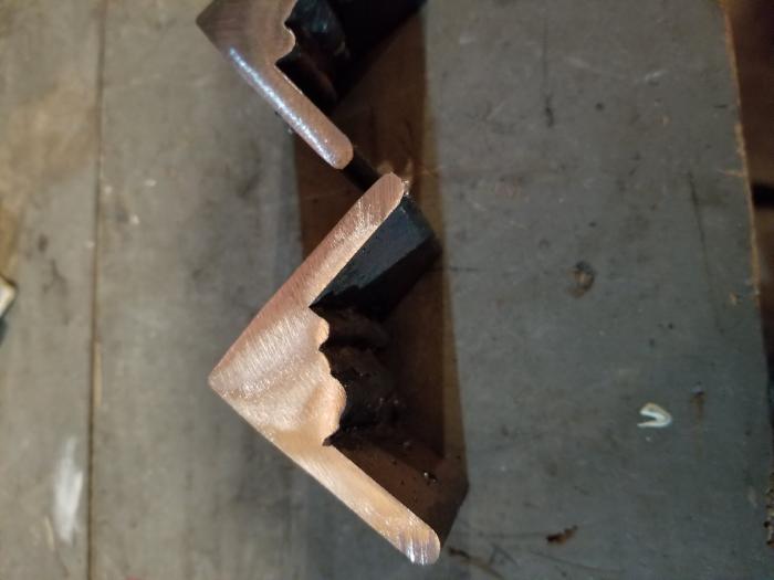

So I decided to cut the piece in a few places and this is what it looked like. Does this mean it would pass a 3G test since I don't see any defects?

Yes the profile and undercut I'm aware of. I was concerned with what's behind all of that. I think it's because I'm using 1/8 rod on 1/4 angle. Gets hit real quick. The test is on 1 inch plate.PeteM wrote:Nah. Although its nice to see what is and is not inside. That undercut into the base metal is too much, and the profile and what not still need work.
Keep at it. It takes some time on the metal.
