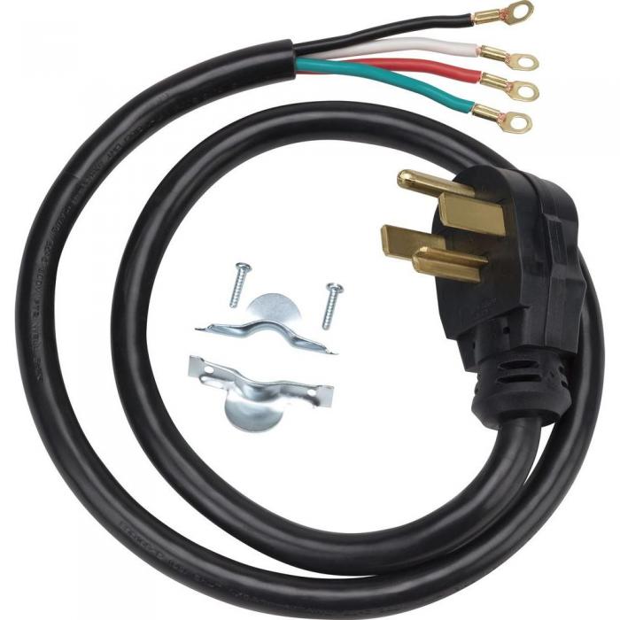

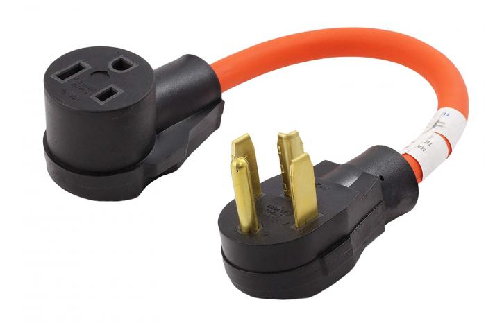

A guy at work gave me a Century AC-DC stick welder that he didn’t want because he bought a new one. He plugged it in to make sure everything worked fine (which it did). I got it home and had to wire up an adapter to plug it into my dryer receptacle. I took a 6ft 30amp dryer cord and plug then wired to a 6-50 welder receptacle and plugged my welder in. I’m using 6013’s and they will only hold an arc on full amperage (250) on AC. Below that and on the full range of DC it only sparks and sticks a little, but never holds an arc. It also seems really difficult to make a large weld bead. Almost like it’s not getting hot enough. That could be user error though. I’ve cleaned all of my material, the ground clamp, and the electrode. This could be a question for an electrician, but any help would be greatly appreciated.

Those wires are not coming from the welder. He bought a commercial 30 amp 4 wire dryer cord and is putting a 6/50 R receptacle on the end of it. The colors are going to be standard in one of those. red and black are hot, white is neutral and green is ground. The welder already had a standard 6/50 plug on it.This is probably correct but to know for certain, you had better open the welder and look at the wiring there. A rule of thumb for wiring colors DOES NOT GUARANTEE how they end up being connected.

You misread what he is doing. He has not removed the original plug. The original plug is there and intact. All he is doing is taking one of these dryer cords and putting a receptacle on the end of it (the end that would normally go to the dryer, not the end with the molded plug). He is essentially making a pigtail adapter to go from a a 14/30 receptacle to a 6/50 receptacle. When he wired up his 6/50R, he took one hot leg and ground, making it back into a 120v circuit.It’s not whether the machine worked, it’s now that he has removed the original plug he should confirm the wiring scheme from the machine inside.
Cord
