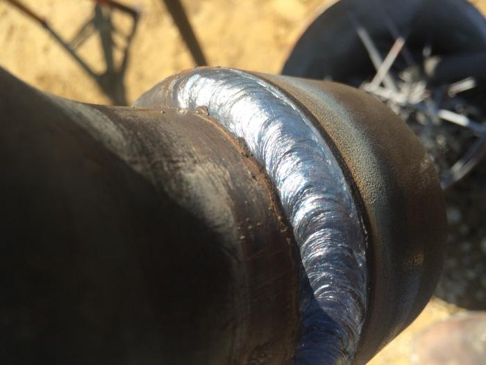

If you bump up your amps a little the bead will flatten out. Go up about 3 amps at a time till you find the sweet spot. If the plate is laying flat and it’s 3/8 or thicker then I’m guessing you’ll end up around 95-100 amps to get a flat bead with 3/32. Practice helps even more than turning up your amps. Slow down on your motion / whip, but keep up your travel speed. I find even when I try to hold still I still have a slight weave that develops. The slower you make your weave motions the smoother the weld will look.
Some old pictures I had on file
One is just a socket weld fitting. The other two are from the base of a pedestal I made.
