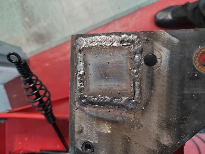

I had a little success too. I cut some squares and got some advise from a coworker on how he does it. So basically I used the 3/32" 6013 and made small circles. I focused about 75% on the 1/8" and 25% on the 16ga.
I know it's not perfect, but the sides were my last 2 welds and I feel they can be good enough with a little more practice.

I think you're on the right track with square sheet metal instead of washer. Galvy can be a PITA.
For a weld that small I wouldn't bother with the small circles technique. Try a simple step technique. Light up, pause for 1 or 2 seconds, scootch forward a 1/16 or 1/8, pause and repeat.
Not perfect, but it came out ok for 1st try.
Oh, forgot to lower the volume on the video. Lower the volume on your computer since the 2300 CFM ventilator fan is full blast.

That looks much better. The "small circles" is basically a technique that we were mentioning as a form of heat control where the majority of the heat (and thus time) is spent on the thicker part, and then the puddle is washed over a little onto the thinner part. As long as the movements are kept within reason and don't deviate more than a mm or two (basically half the thickness of the rod, roughly), you shouldn't encounter too much slag entrapmennt. As you keep practicing, you will get the hang of it.silentneko wrote:I had a little success too. I cut some squares and got some advise from a coworker on how he does it. So basically I used the 3/32" 6013 and made small circles. I focused about 75% on the 1/8" and 25% on the 16ga.
I was going to say the same. I would do a straight drag or a slight weave. A step and pause would be ok but I would not wash back into the weld with any of the techniques. I could be wrong but I think you will create slag inclusions. In the end this project is not critical so no big deal.

As far as the little circles, I mean real tight, almost a weaving pattern. My friend at work used it on a test run, and nailed a perfect weld the first shot. He used to do it for a living.

I got half of it done last night. The first 8 plates are welded on. After a lot of playing around I went with 5/32" 6013 at 65 amps.
Here are a few shots. I know they aren't super pretty, but they will work.
