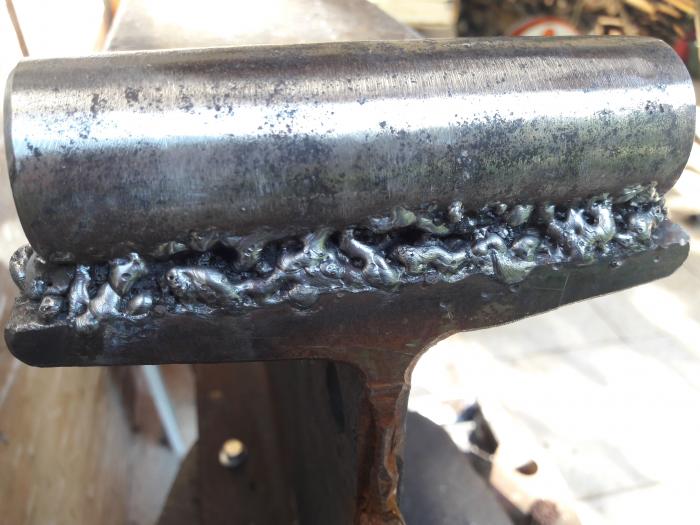

Hello, thanks a lot for your answers,
My rods are AWS E 6013; I don't know what that means, I just bought what was available at my local store without thinking.
My welder is AC and, after just checking it, the current was more 80 than 90 A, something like 83 A.
The steel I tried to weld in this case is 4 mm thick. As you said you gap is way too large. I'll try and buy 3 mm to see if it makes things better.
Outside of the gap issues, here is another example of a VERY ugly weld (joined picture), where I did three or four passes with some angle grinder in between. At the start there was no gap, it was a contact between a cylinder and a flat surface; and I still get these "porous" welds where flux gets deep into the weld at random spots.
Here the flat piece is about 15 mm thick and the cylinder about 40 mm in diameter. I used the same amperage and rods.

More info on the pieces :
I cut the cylinder from a plough tooth, so I guess it's spring steel, or at least some sort of carbon steel.
The flat surface is a piece of an I beam originating from a bridge, so maybe not mild steel but a much lower carbon content ?

i think the problem here is more about joint configuration and how your going about bridging gaps.
it looks like your trying to weave from one side to the other. that won't work with small rods and big gaps, as you will get slag inclusions (those deap holes of slag).
with small rods and big gaps you really need to run a bead. clean off the slag, then run another on top of it.
a good way to practice is T joint and stack beads.
jody has some good video's of stacking beads.
on your first pic, it should have had a bead along the edge. clean, then weld next bead on top of that, then clean and weld last bead along the top.
6013 is prone to slag inclusions and you can't 'burn the slag out.'

Thanks a lot, that clarifies things for me !
Weaving is exactly what I try to do, as my uncle once recommended that.
And when I get these slag inclusions I just go "maybe by making another pass over it it will go away"
I will stop weaving and try stacking beads instead.
Another question : when you weld a bead, do you make any motion with the rod, like a tiny circular motion, or do you just go in a straight line trying to keep the puddle consistent ?

For the most part as your just starting to learn, focus less on motions with the rod, and more on just steady even travel speed while maintaining a consistently short arc. After you’ve run 40 or 50 lbs of rod you’ll probably have enough experience to begin to add things like rod motions IE side to side, forward and back, or circular, or some variation/ combination of these motions to your bag of tricks. Each different motion or pattern will affect the bead in different ways and depending on weld position, body position or metal configuration. What works for one combination of variables won’t work for all.

with 6013, especially the double coated rods, its very easy for the slag to slide around the side and if you go sideways to much you weld over it and you trap slag.Solmyr999 wrote:Thanks a lot, that clarifies things for me !
And when I get these slag inclusions I just go "maybe by making another pass over it it will go away"![]()
so keep it fairly straight.
also keep in mind the arc is blowing the slag back. if you have next to no rod angle the slag can slide forward.
so watch the rod angles and don't be afraid of running a fair bit of rod angle.
Your not watching your puddle and manipulating your electrode to move the puddle where it needs to go. Don’t watch the arc, watch the puddle behind it.
Your also moving too fast and not allowing your puddle to build/flow onto each of the pieces of metal.
God****ed 6013s.. and a huge gap to boot. 6013 are really prone to slag entrapment, you'll see it in the puddle swirling around often displacing or being confused with molten metal. You'll notice it's a very fluid slag and it'll easily run ahead of your electrode if you travel too slow. I don't have much experience with them, and I avoid them whenever possible however one bit of advise is actually to travel faster than you would with other rods. It's better to do a multi pass weld laying down only a small bead each pass than end up with big globs of metal on either side of the joint and nothing but slag straight down the center.
