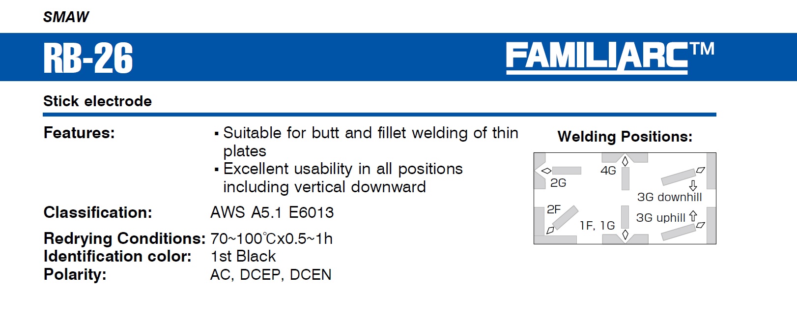

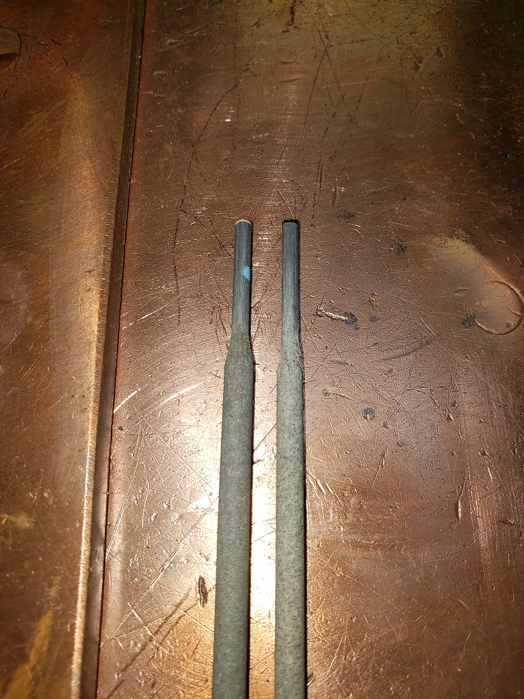

No. "All position" simply means flat, horizontal, vertical, overhead. Most rods, with very few exceptions are not to be run vertical down. Most 6013, even in the flat position, it's hard to see the puddle, as the slag wants to run forward and cover it. Even a slight downward angle, and it'll keep running right into the arc. In the case of the Kobelco RB26 rod, it's specified by the manufacturer as a downhill rod. In the attached pic, the rod on the left is a typical lyme-titania flux 6013 (Kobelco Z44), and the rod with the thin flux covering on the right is the fast-freeze 6013 (Kobelco RB26). Both are 2.6mm or a little bigger than 3/32".
- 20210820_204951.jpg (423.98 KiB) Viewed 11540 times
- RB26.jpg (172.79 KiB) Viewed 11540 times
lime-titania is typically a stainless electrode. interested to see a mild steel one.JDM Welder wrote: ↑Fri Aug 20, 2021 8:13 amNo. "All position" simply means flat, horizontal, vertical, overhead. Most rods, with very few exceptions are not to be run vertical down. Most 6013, even in the flat position, it's hard to see the puddle, as the slag wants to run forward and cover it. Even a slight downward angle, and it'll keep running right into the arc. In the case of the Kobelco RB26 rod, it's specified by the manufacturer as a downhill rod. In the attached pic, the rod on the left is a typical lyme-titania flux 6013 (Kobelco Z44), and the rod with the thin flux covering on the right is the fast-freeze 6013 (Kobelco RB26).
