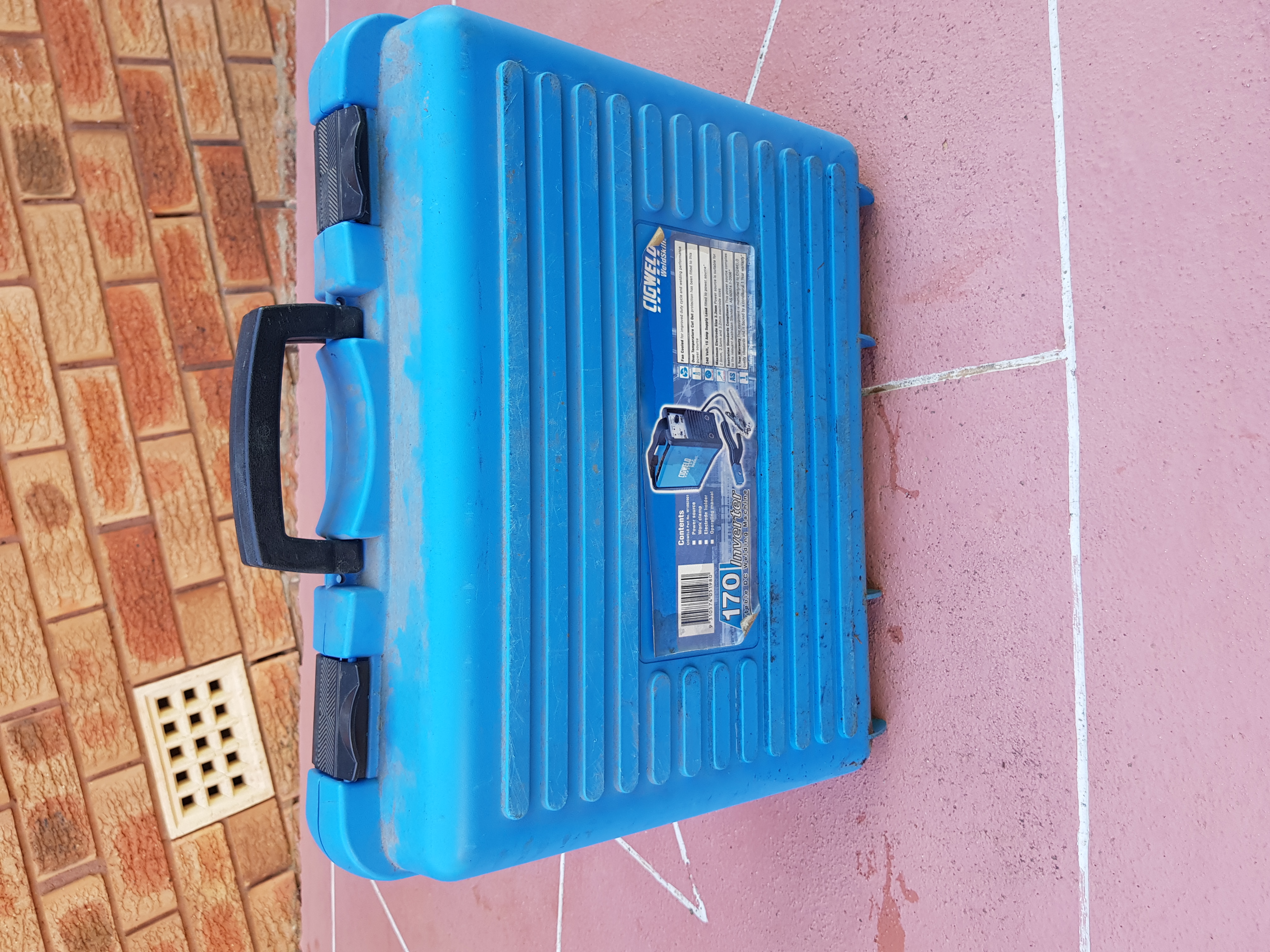

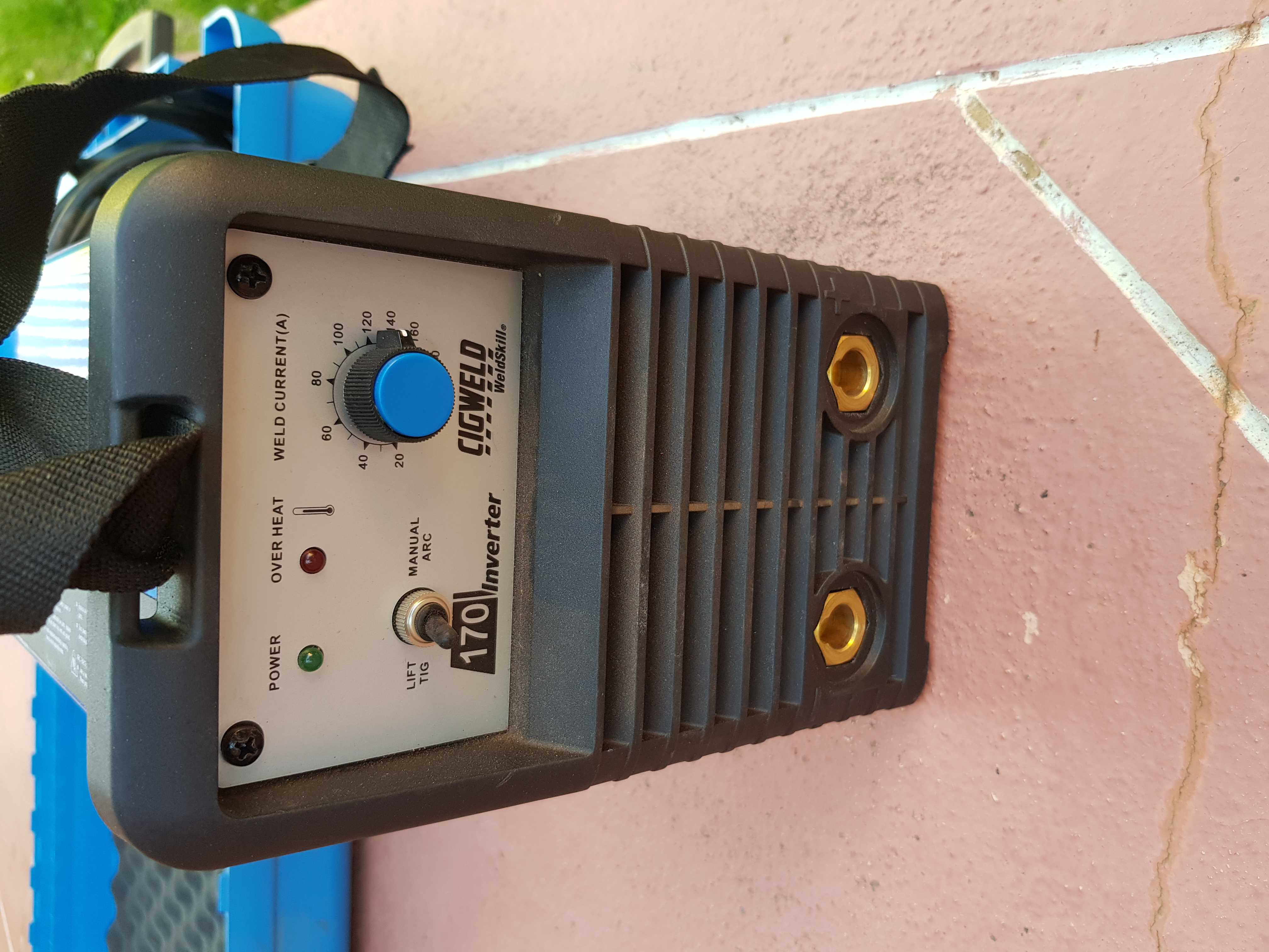

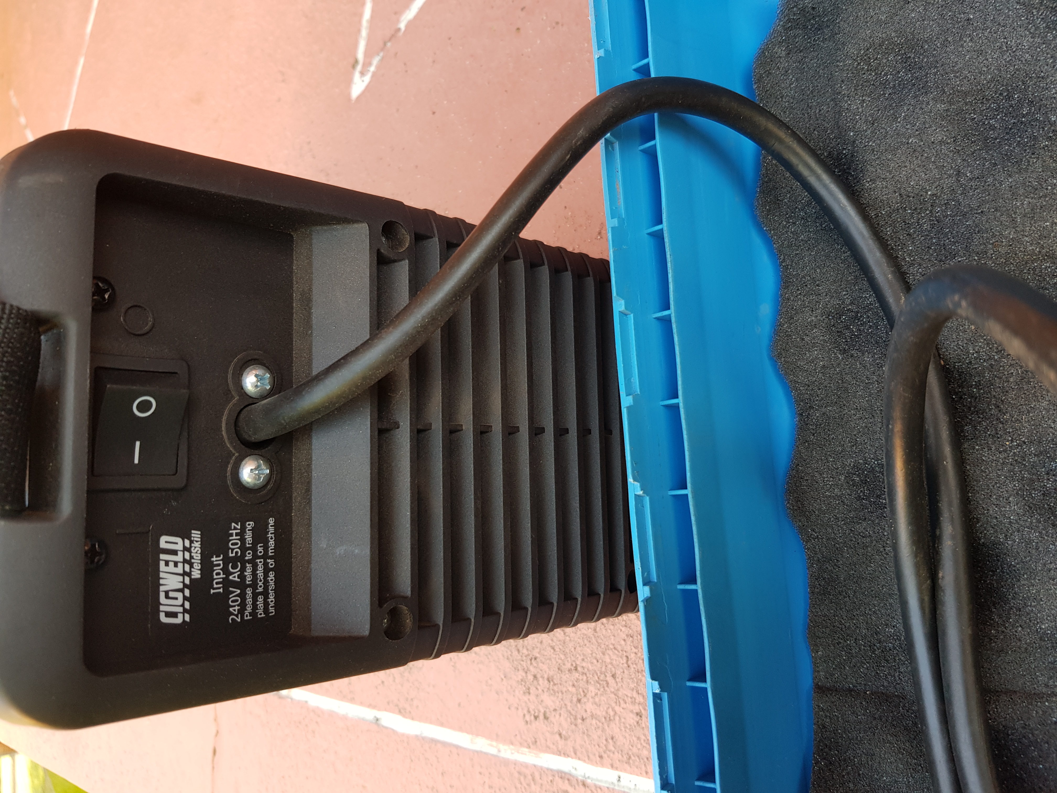

The case is not uber quality but will last you a heap of time. And will keep the welder immaculate in most conditions. I have the same case for my decade old rooter. It looks abit like the welder too. ;) Just smurfed up a bit :?
If it is similar it will be bulletproof and accurate for many years.

Gdarc21 wrote: ↑Sun Oct 17, 2021 3:11 am The case is not uber quality but will last you a heap of time. And will keep the welder immaculate in most conditions. I have the same case for my decade old rooter. It looks abit like the welder too. ;) Just smurfed up a bit :?
Very similar to that one it appears, but with DV capability and PFC.
I have this same little CIG but mine has HF on the tig function and down slope/post flow.
Not an advanced tig by any means but a real handy little machine for remote jobs with the luxury of HF and gas solenoid.
