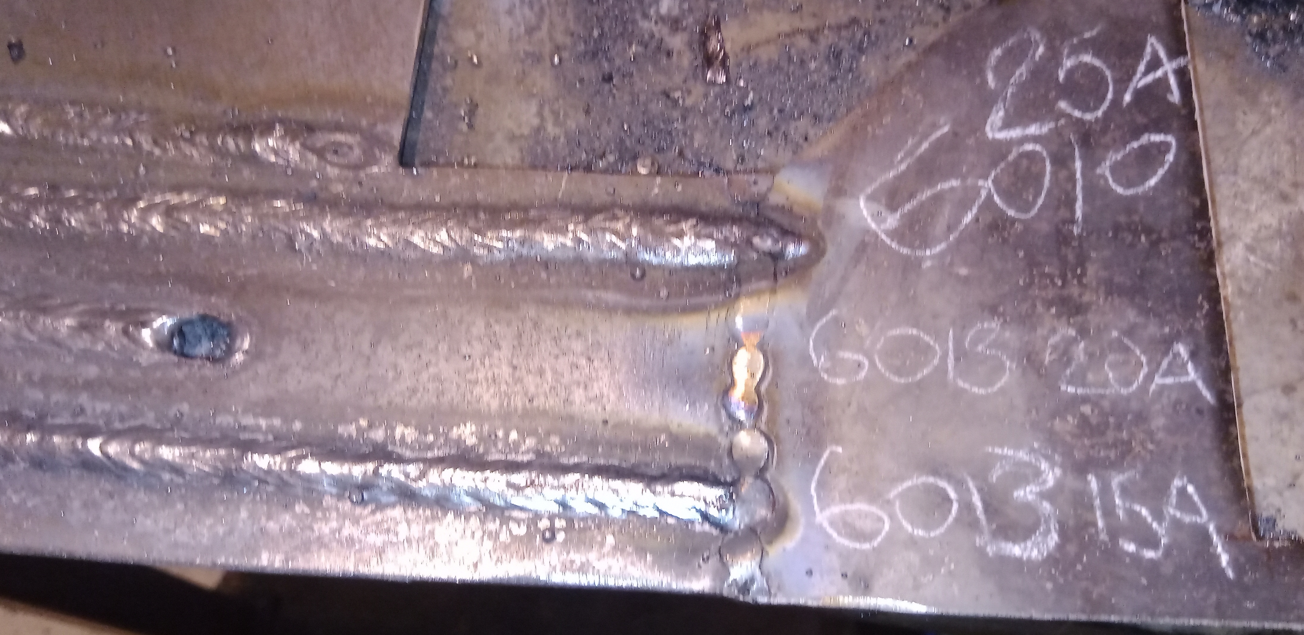

So I was dicking around wtih vertical for a while ( on a 6mm plate ) and went 'yeah nah yeah time for something different' and tried some 6010. I normally weld with ear plugs in out of habit, but this time did not, and holy shit was 6010 noisy in comparison to 6013. ROOOOOOOARRRRRR SHHHHHHHHHHHHHHHHHHHHHHHHHHHHHHHHHHHH! it said, in no uncertain terms.
Then I thought it was my duty to re-try 6010 on thin metal, the scrap I brought back from work. I set my arc force to 10 ( the max on an EWM pico 160 cel puls ) and compared a 6010 to a 6013.
So yes, the 6010 was at 25A, and doing a whippy type thingy, and because I could see the puddle it was super easy to see what was going on.
6013 at less amps than the 6010 blew through. I practiced about 5 times outside of the shown picture before I got a setting for the 6013 that semi worked, which initially was 20A, ( the middle one which blew through ) and then 15A, which seemed to work ok.
I am starting to wonder if I should have just used an arc force of 10 instead of 0 with the 6010 on the most recent job, and might have had a much better time of things. It was for sure shit loads easier to control.
The metal was 1.6mm, and the rods were both 2.5mm.
- thin metal thingys.jpg (5.75 MiB) Viewed 23720 times

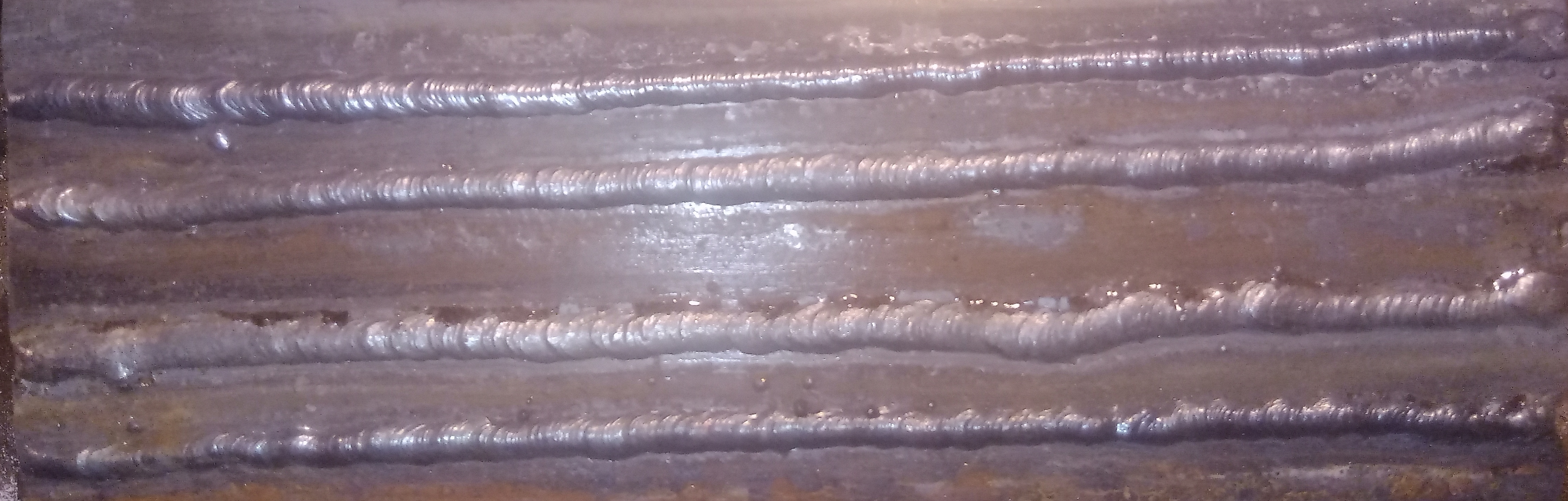

So these top 4 beads were done @ 40 amps, 70 Hz, 50% balance ( ignore the 50hz chalk ). They are 2.5mm rods, electrode negative.
The ones below it were of 2.5/2.0 mm rods, at around 35 amps, but just normal straight DC, no pulse ( from about a week or two ago ).
An interesting thing I have noticed with this pulse business, is the pulse noise increases with arc length... so its a very cool gizmo to help regulate arc length I just need to download some coordination from somewhere to make use of it

More dicking around;
From top to bottom;
6013, 45 amps, EN
7016 45 amps, EN
7016 40 amps, EN
6013 40 amps, EN
I found 6013 easier to follow the chalk line for whatever reason. Perhaps because of the shade I am using, I am not sure. Also the 6013 definitely sounded smoother, and was more consistent in its arc behavior in this nice easy flat situation.The 7016 was a bit more bubbly in comparison, as in it was sounding like pshhhht pt pt pt pshhhhhhht pt pt kind of thing.. sort of like the normal crackles with 7018, but more frequent and slightly louder.
- 6013_vs_7016.jpg (4.01 MiB) Viewed 23310 times
6013, 45 amps, EN
7016 45 amps, EN
7016 40 amps, EN
6013 40 amps, EN
Interesting thing I have found with pulse, with both 6013 and 7016. Without pulse, I was running into occasional situations at low amperage's (around 30-50 amps on 2.5mm rods) where the slag was starting to cover the puddle. To fix this I was previously kind of slightly long arcing with steep rod angle and/or doing slight C weave type things to push the slag back, but it was a pain in the ass on occasion. I tried pulse, initially at 200 Hz but this was obnoxiously loud and annoying, but then at 20 Hz. Both settings though, seemed to help push the slag away,.. and so the only manipulation left was to actually put the metal where I wanted it. Quite interesting. The beads ended up looking like a normal beads with the normal tiny fine ripples, with both 6013 and 7016.
