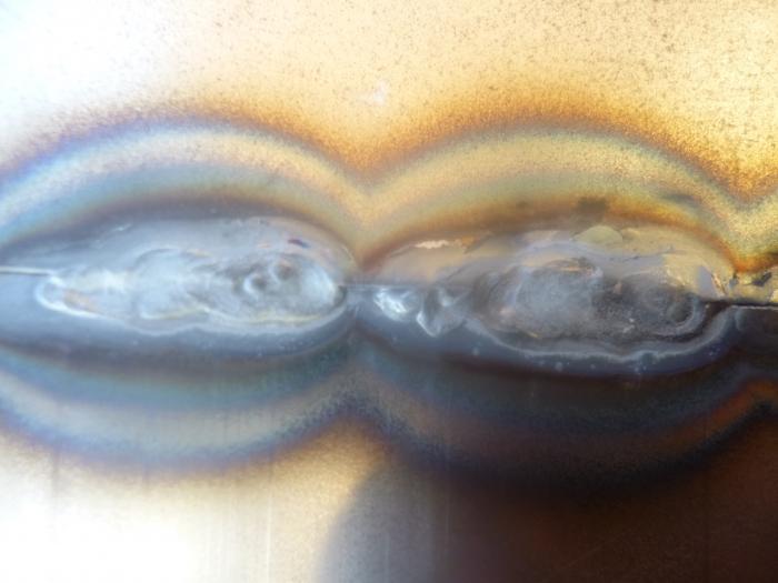

For now, here is my humble attempt with a butt joint on 20 gauge sheet metal. I know it's sloppy but wanted to get the ball rolling on getting specific input. These are 2 separate runs, about an inch in length, the 2nd one done after the 1st cooled a little, since warping seems to be the bigger challenge than burn-through:
- HF's 1/16" 6013 DCEN
- About 26 amps
- Flat position
- Rod position just shy of perpendicular
- Arc length probably jumped around due to my inexperience but I tried to keep it "medium"
Comments?
This is the backside. Is it supposed to look like that or is that good/bad penetration?
And is a wet rag really the best way to minimize warping?

wet rag is good, as its about "shutting down' the heat before it make the metal distort. That and a big block of metal, steel, alum or copper is better, to suck the heat away from the thin metal.
Pre setting is good, if possible, where the sheet/ part it flexed and clamped away from the weld, and when it pulls, it will end up flat instead of bent too far.

The root penetration in the pictures, though not consistent, shows what you're looking for. The weld (root) on the right has about 2/3 of it's length as "spot on". You wnat to see the sharp line of the joint vanish completely, and just a wee bit of material pushing through (back-side reinforcement).
I'm not experienced on DCEN stick on thin sections, but it sure looks like you're on the right track.
As for the "top side", it looks as you expected it to look. Not half-bad, all full, and just needs practice to get to "pretty". You've figured out the basics. Hood-and-hand time will give you the rest.

Otto Nobedder wrote:The root penetration in the pictures, though not consistent, shows what you're looking for. The weld (root) on the right has about 2/3 of it's length as "spot on". You wnat to see the sharp line of the joint vanish completely, and just a wee bit of material pushing through (back-side reinforcement).
Thank you for the encouragement. Will keep working on it. I think controlling arc length is where I'll be focusing on at this point. I do see there is a fine line between filling up the seam all the way through and burning through.
