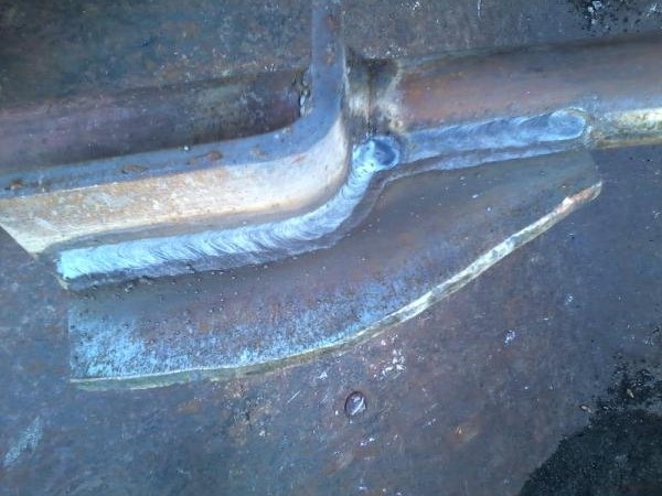

Progress today, 6013 @ 90A... let me know what's wrong :) thanks, Andy

Your movements are much too large, slow down and build up some metal.

MinnesotaDave wrote:Your movements are much too large, slow down and build up some metal.
Keep after it :)
Thanks Dave, will try the other half of the pad tomorrow.

Maybe too big a step?
Or is that "normal" for these?

No it Is not normal.
Here is the last bead of a 3 pass weld.
I don't use 6013 very often, but ran out of wire and other rods, so I used what was left.
This was AC, 1/8" rod, about 135 amps.

I just weld it the same as I do 7018 and 7014 - enough amps to drag with the flux touching the plate - especially true in fillet welds.
My normal drag angle is 5 - 15 degrees, sometimes just straight in.
The rods are nothing special - Washington Alloy from my local hardware store at $2 per pound.

Ok Dave, I am avoiding touching the work with the rod but trying to maintain the smallest arc gap possible. Can I touch down with this rod after its started? do I need to push (feed the rod in) ? Thanks

Slowed right down and tried not to pause...
6013 @ 90A, DCEP.

With your 7018 you can lightly scrape the flux on the plate, if it sticks doing that then the amps are likely too low.
If I run an arc gap, it's only about 1/16" or so.
I don't really push on the rod, I just run hot and let it burn, constantly feeding it in as it will take it - provided you are following the rule of thumb of never trying to weld metal thinner than the rod.

That is looking much better :)
Looks a little cold though - I'd like to see it flow out wetter on the sides, if this is 3/32" rods, try 95 or 100 amps and see how that feels.

Ran a few at 100A, yes it is 3/32" rods. How does it look? Know I need to work on rod angle and travel speed.

Coming along very well - it's all just practice from here :)

You can drag 6013 rod just the same way you would 7018. your beads are looking good. work on consistency.

Dave's advice is what I recommend at the moment... You have the basics down. Stop putting heavy stock in outside advice, and practice what you've learned so far. Pay attention, as you now know what to look for, what's right and what's not.
Once you're comfortable padding beads and making them all look the same, then ask more questions.
Remember, "If it were easy, everyone would be doing it!"
