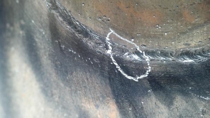

About the pics:

5.) the circled part is the tie in with the tack where it didn't fuse properly.

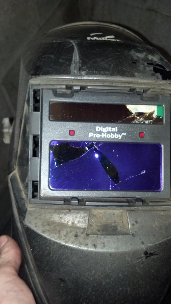

6.) after four weeks of welding various sizes in 5G and making little headway, I got very frustrated today after welding the first root pass on a coupon. I didn't like the results and let my anger get the best of me and threw my hood on the ground--twice! So there goes $130.00 down the drain. As for the hood itself, it's a Miller digital pro hobby and for the price and quality I'd recommend it to anyone just learning to weld as it has a decent size window and is lite. The only two down sides are that you can't torch cut (or grind) wearing it and isn't too great TIG welding. But, when I got home today I did order a used one.

One thing that may help with tie ins to your tacks. When getting close to the tack, angle the rod towards the tack.
If I'm running too hot, or a big gap, I point the rod back on already deposited weld. If I'm running to cold, or the gap is closing up on me, I point the rod forward to have more of a cut.
