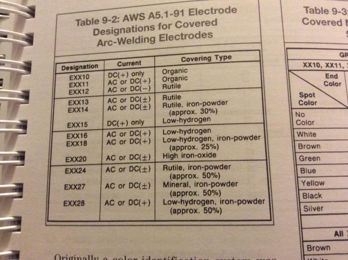

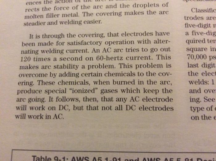

Yes seriously! Unless you have a WPS stating to only run DCEP. DCEN will help prevent burn through. I don’t see how running on DCEN would fail an xray.
Alright, well ill give it a shot tomorrow after work. Ill report back with results.Shield Arc wrote:Yes seriously! Unless you have a WPS stating to only run DCEP. DCEN will help prevent burn through. I don’t see how running on DCEN would fail an xray.
- image.jpeg (63.81 KiB) Viewed 1739 times
- image.jpeg (62.53 KiB) Viewed 1739 times

Yeah i have some miller calculators and the stick amperage calculator tells me that 7018 should only be run on DCEP. Im just gonna change the fit up and run colder i think. Then turn it up after ive set in my root.Poland308 wrote:image.jpegI recently had to do some reading on rods do to my making a less than informed comment on the topic.
