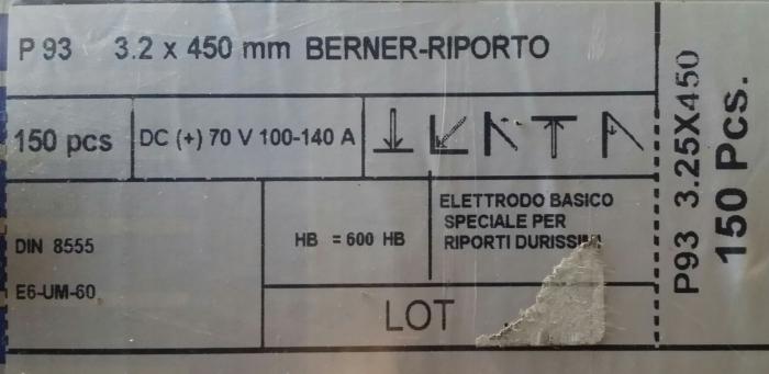

Received this box of rods from a sales agent for a tool mfg company. I had ordered regular 6013 rods though. So I thought they were 7018. Doesn't say on the box. Only has ISO number and I'm not familiar with that.
I welded a bit on a loader bucket today and the weld would crack right thru the middle after a while.

A google search and some translation from Italian suggests these are hardfacing rods. https://shop.berner.eu/it-it/p/132432-e ... _id=132432

They are hardfacing rods. DIN8555 calls up more than 0.5% carbon and significant manganese content plus other possible alloys like chromium. Which explains your cracking beads.
For hard surfacing rods they actually weld good! I had no problem with fusion or laying a decent bead. And I cannot say that they were more difficult to grind flat either...
